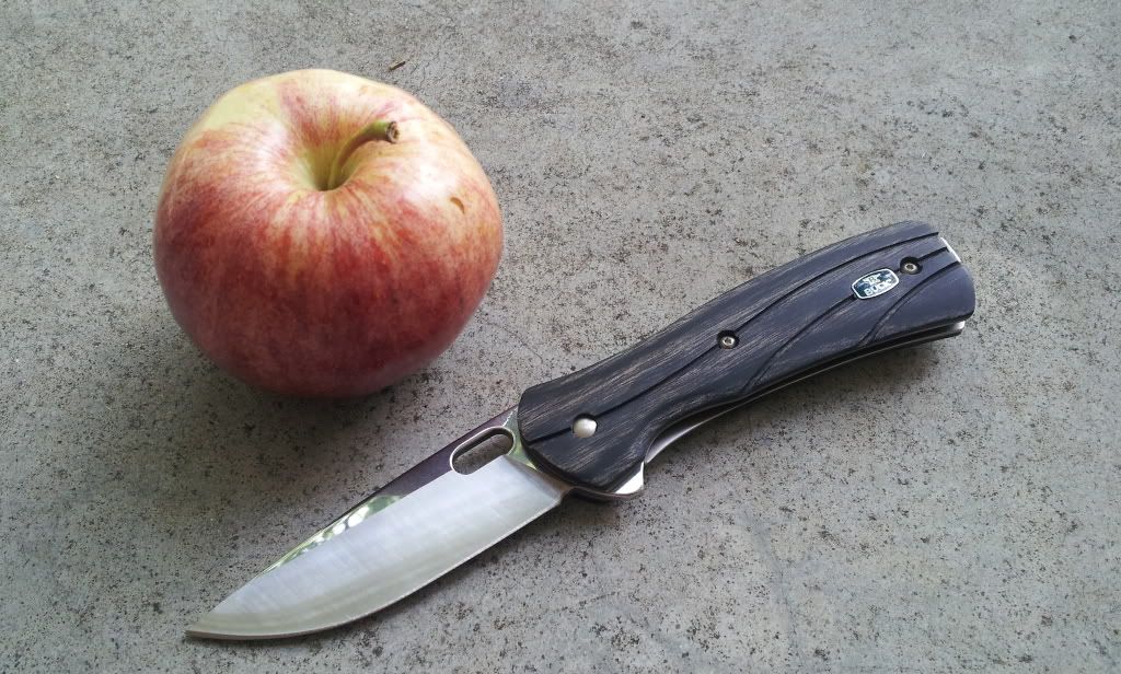

Ok guys, is my pic in the first post a Select or Avid? Its designated "345" which made me think Select, but some guys are telling me Avid. Does the polished flat mean Avid? Thanks.
No, yours is a select. Buck made the diamond wood in the flat finish for Walmart. The high gloss finish is the Avid.
