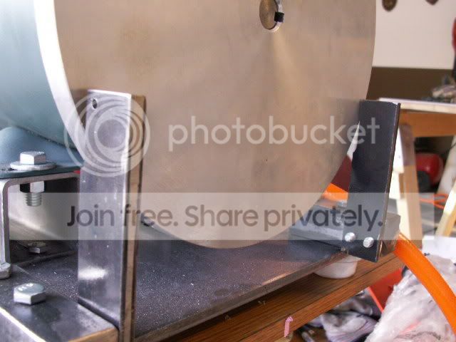

The motor pads, worktable base, leg mounts are held with 1/4 20 hex bolts, all ends tapped. I am going to get some knobs to mount on the end of the 1/4" bolts that are for worktable removal.
4x 3/8 bolts to mount motor to pads
4x stanley industrial doorstops for rubber feet
I was debating whether to have the disc right up to the edge of the machine base, overhanging, or inset. After not much thought, the disc is "flush" with the machine base.

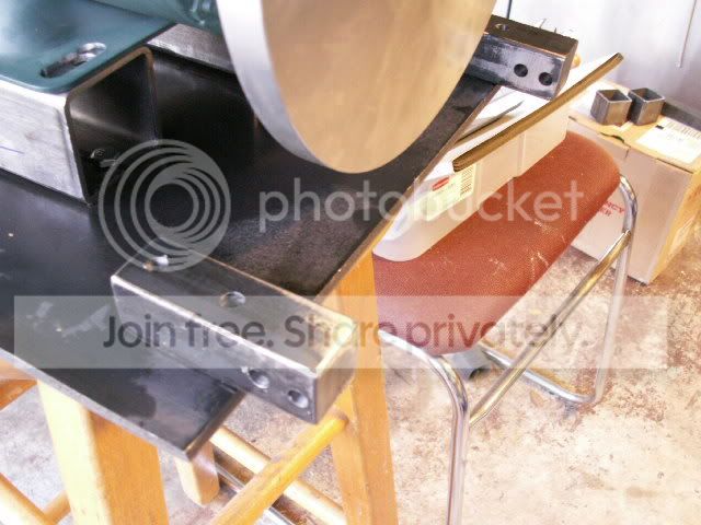

tapping base for pad bolts
"dry" fitted motor pads and motor
measuring for worktable mount placement

Well, spent most of the day cutting the 1/4" plate for worktable and legs. Drilled and tapped holes for worktable base mounts, ground bolts flush for "cleaner" look. Heres a photo of the doorstops mounted for feet.

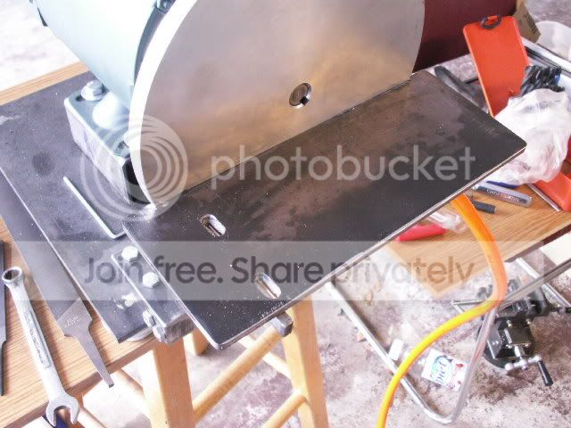

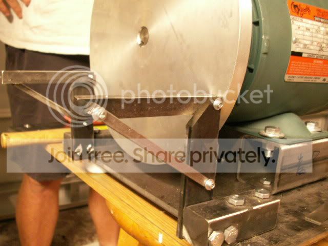

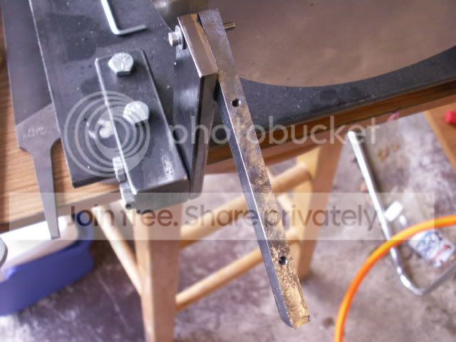

ok, got the table legs done, fitted, one table pivot mounted, drilled, tapped. The end is near. I drilled and tapped for 4-40 bolts for pivot and table mounts to pivots. I went with small bolts since I am not going to use this to hog metal, more for fine detail. Oh yea, if anybody asks, be careful using a 1/8' end mill cause if you push it the bit will go "PLINK"! and snap real quick. Ask me how I know this. Still looking at my design for taking the table off for paper replacement. not exactly the most efficient method, but it will work. I think I am going to hold off on slotting the table legs for 100% adjustable miter till a later date. For now I can use different lengths of 1/4"sq stock on the back side of the table to base. Pics...
Fitting table legs
table pivot
table test fit

I like it very much. If you replaced the 2 diagnol supports on your bed with sq tube with a set screw and sq stock wouldn't its angle be adjustable and very sturdy?
Square tube would be definately more sturdy than my setup now. If one were to use this for serious grinding, then my setup would definately not work. There is not too much play in the parts when the bolts are loose, and when everything gets re tightened it pretty much comes back to a hair around 90deg to the disc. It is more solid than it looks.
