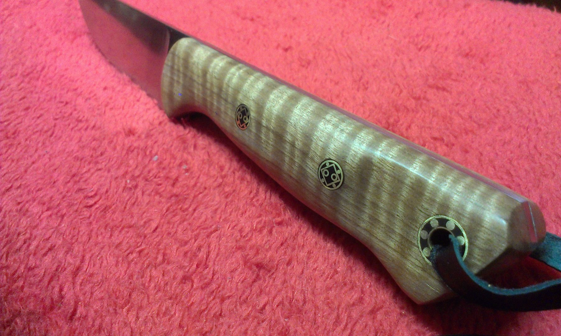

Surprised no one has mentioned CA. Not a lot of fans here it seems. I've done a number of things with CA lately and I'm struggling to find something that I like more.
HF sells a big-ish bottle that should have more than enough to do one or more sets. It's cheaper (on sale) to buy the small tubes of super glue, but there's the convenience factor. I'd especially consider it for the birds eye.
Is it the small bottles for like $1-3?
If not, could you send me a link?
You may want to get rid of the link. I believe that it's okay for me to say what I did, but as I understand it, a live link is a no-no. ;)
Yes, I bought several of those tubes. They also stock a big bottle at my local store. I read the ingredients when I bought them (you never know) and it is in fact Cyanoacrylate. There are a couple of associated products that people sometimes use with CA. Debonder, to soften the glue if you get problem areas, and quick setting spray. I might try the spray as the layers seem to dry slower as you apply them. If you're a smoker, the smoke does a decent job of doing the same thing.
Pen turners use CA very frequently. A youtube search for "CA pen turning" will get you a few good videos.
Good luck!
Thanks, I saw some people use a polishing compound like turtle wax to finish the handles. Do you use anything like that? Would green compound like the type that you put on a strop work? Do you have any pics of a finished CA finish?
Thanks for your help! :)
Green ChromOx would be pretty abrasive. I use white compound on a microfiber towel. The white compound is usually for plastics. Since the CA finish is (more or less) an acrylic layer, the compound works well.
I don't have any good pics on my phone, but here are a couple so-so shots.
