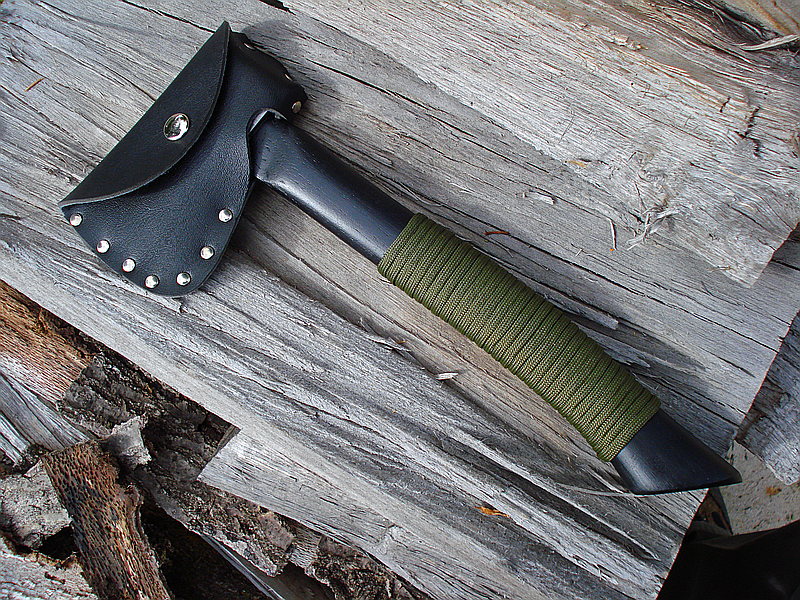

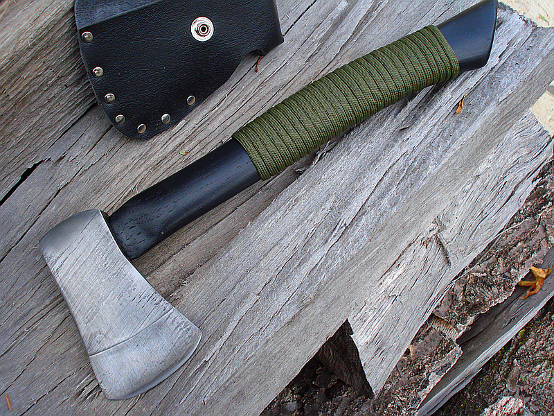

Bought this Sub Zero some time ago, finally got around to modding it. I mostly followed this tutorial: http://oldjimbo.com/survival/vaughangrind.html

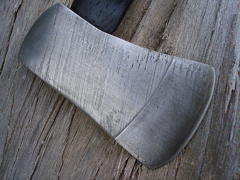

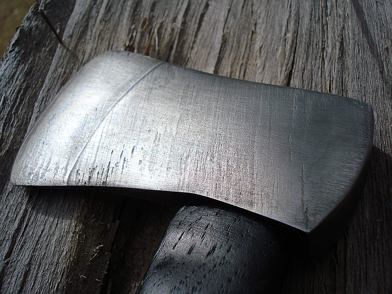

I ground the head down per the tut. Tried cold bluing the head, but it kept streaking on me, so I went another route. I soaked the head in apple cider vinegar for a few days, to darken/patina/etch it. You can actually see where the heat treat line is. Painted the handle black, and paracord wrapped it. Cool little hatchet, but I feel the eye socket is way too small. I always forget to take before pictures, but I did take one when I first got it:
You can see how small it is next to the BK2:

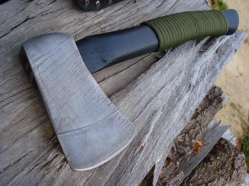

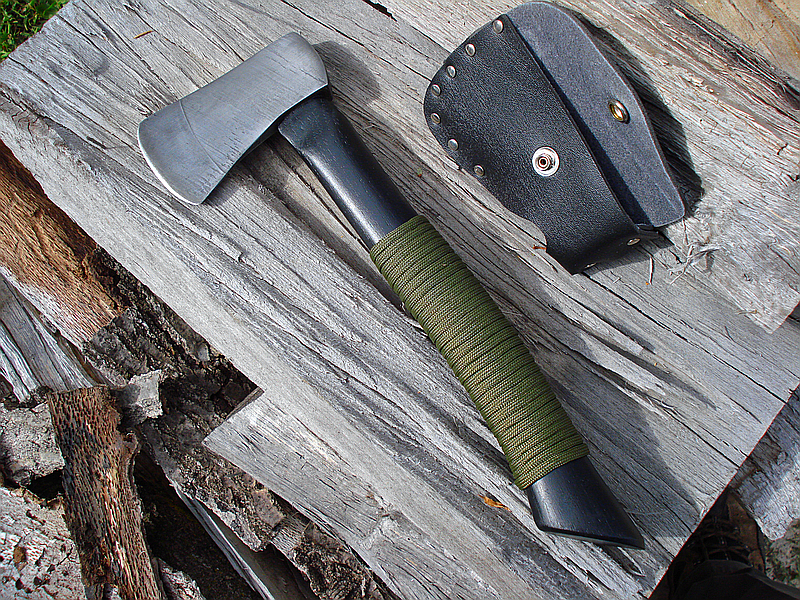

The mod:
Back in the cheapy sheath that came with it:

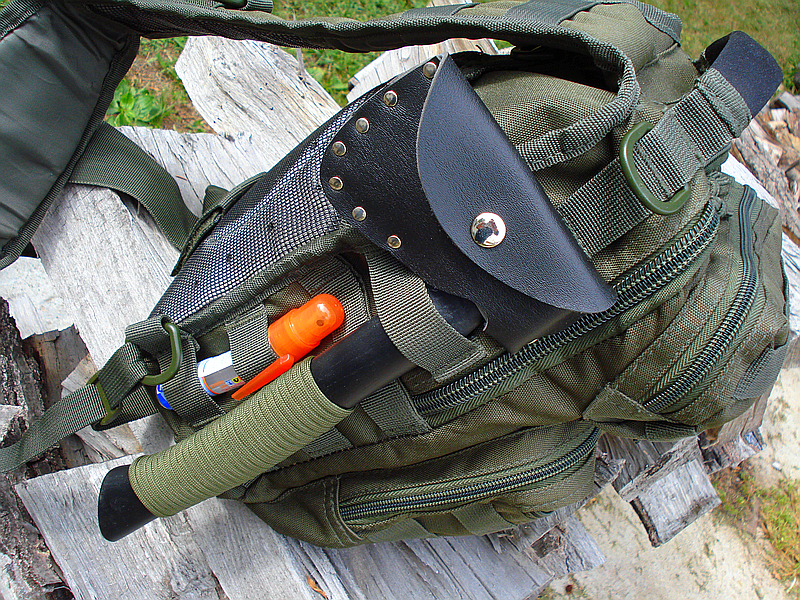

Back home in my Maxpedition Lunada Chinese rip off bag:
That's very cool, I love how the patina turned out. How do you finish off the paracord? I have one of my Fiskars wrapped but I can't figure out how to finish it cleanly.
Thanks. Just Google paracord wrapped handles. There will be several show up. This is the good side, lol. The other side never looks as good, where you pull the cord through, cut the ends, and burn them.

It's a sweet little hatchet for small jobs. I actually need to finish sharpening it. I started, but wanted to post it. Impatient I am...
I like it alot! Mine came with a very flat edge. It was quite a workout with a file and sandpaper, but fun working on it.
Thanks. My edge was pretty much not an edge at all when I first got it. Blunt comes to mind. It was a blast modding it. Love modding.

handle seems thinner when blackened than lackered,did you work at it,or is it optical effect?
nice job.
Thanks man. Surprised to see this one bumped up. Just sanded lightly, and painted it. Of course, wrapped it.
