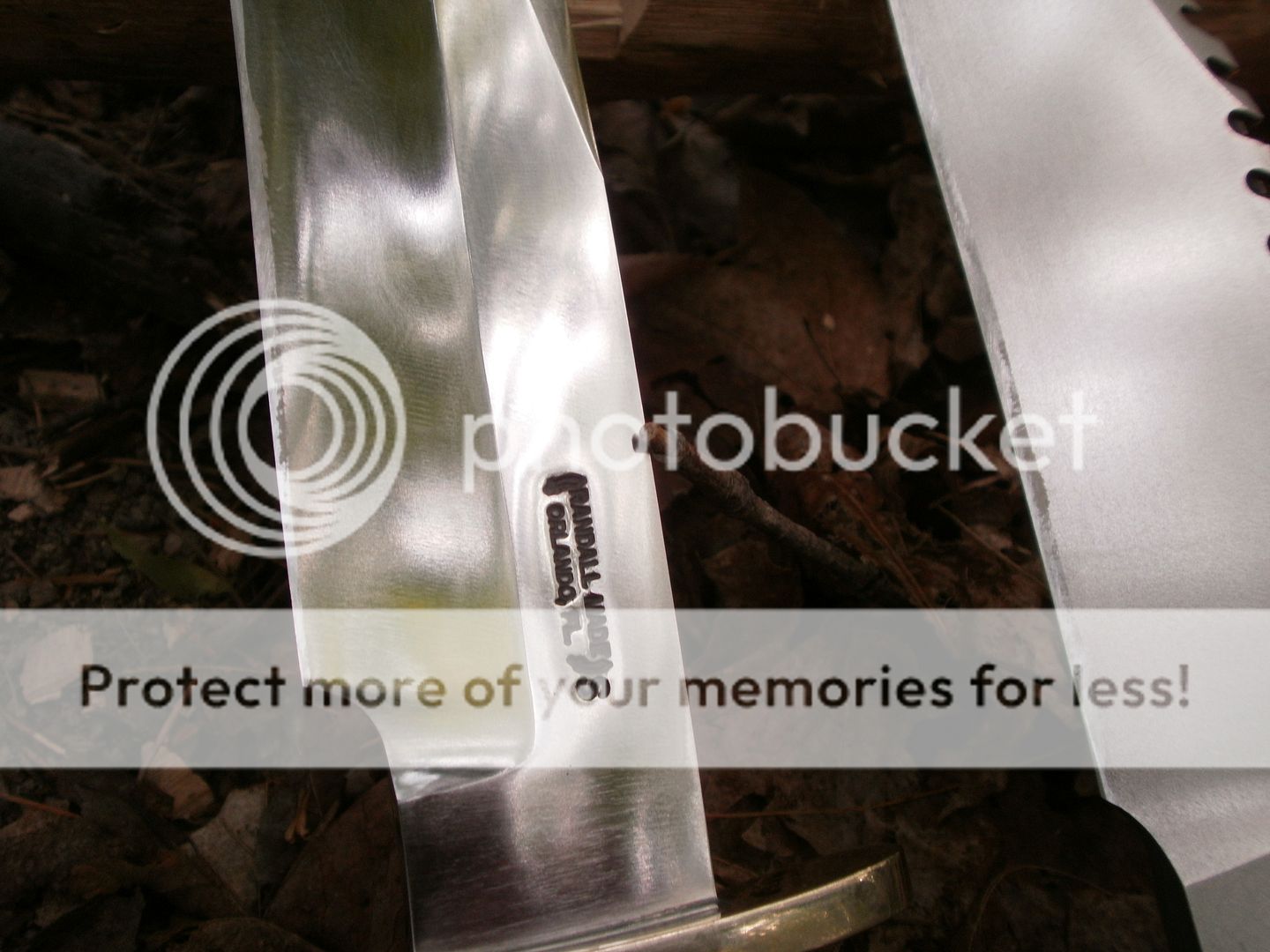

This is the edge condition a Lile and Randall were in, also re-profiled by me, after chopping hundreds of time in the very same log that destroyed the Neeley edge in the next photo in around 30 strokes...
Believe me the edge angles on the Randall and Liles were much thinner than the "inappropriate" angle on the Neeley.
I really appreciate that over the phone you apologized to me for having been rude to me after I posted the above picture of the Neeley's crumbling edge, but your behaviour since doesn't exactly do you any favours.

I'm sorry if your feelings keep getting hurt, but you're rambling on about things you clearly don't understand, and at the same time attacking the work of a veteran maker. If you would type less and listen more you would be doing yourself a favor.
I designed my knives to do exactly what I want them to do, which happens to include being aggressive slicers. That includes using the grind, steel, hardness and edge geometry to accomplish that purpose. Neeley designed his knives for a purpose also, clearly a different purpose than you have in mind.
You have altered it (in a very amateurish and hideous way) to meet your purposes and are causing it's failure. You can't just alter one aspect of the design that drastically without causing problems.
All the components and aspects of design have to be taken into consideration. Also, whatever the bevel thickness was further up the knife, the edge was paper thin on the hack job you performed. That doesn't work. Hence the failures you are experiencing.
Look again at my picture of your shoddy work. That is not how you do it. All the arguing and obfuscation won't change that. I wish you luck.
Also, kind of bizarre of you to attack my credibility because I am able to accomplish the very thing that you cannot. Don't make this personal, that doesn't help anyone.
