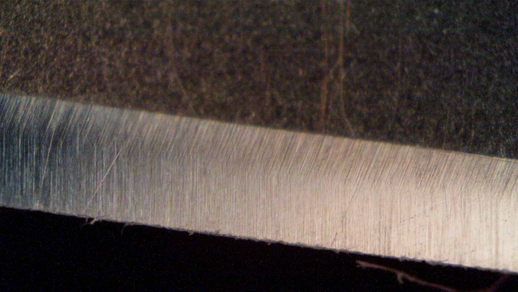

For uneven bevels, if you do worry about them a little, I think the best solution in most cases is to work the side with the narrow bevel more than the wide side. Apex the blade on the skinny side and then keep working it to start evening out the bevel width. Don't try to do it all in one sharpening. You can even it out over the course of 2 or 3 sharpenings.
The uneven bevel I’m referring to is not from side to side, but exist on a single side of the blade as if you are trying to sharpen a convex edged blade on a fixed system without the angled attachment. My apex is centered within the blade and is not the issue.
Think about only one side of the blade. If the stone you are using is thicker on one end than the other, you end up with an ever so slight convex edge (with the thickest part of the stone furthest away from the pivot point). If the next stone you use, has a different “angle” due to being either straight, less, or more, angled than the previous stone, it will not contact the bevel the same, and in some places won’t touch the bevel at all. Yes, the convex edge is extremely slight in this case, but it exists.

I completely agree that “side to side” a one degree change in bevel won’t make any real difference. However, read in post #4 where diemaker talks about looking at bevels under a microscope and how, when changing stones, on the same side of the blade, a .02” change in thickness of the stone can mean only polishing half of the bevel unless the change in thickness is compensated for. This is exactly what I am experiencing. The variance in stone shape and size is causing only a portion of the bevel to be polished by the next grit of stone unless I spend time adjusting between each stone. I don’t have to adjust side to side when keeping the stone the same, only when changing stones during the progression.
With any and every stone brand or type - doesn't matter who makes it or where it's from, I would recommend getting into the habit of using your angle cube to readjust your angle each and every time you swap stones. For consistency, measure it on the same side of your blade, in the same spot on the stone and blade.
Even if your stones are 100% the same thickness when new (which hardly any stones are), invariably they will start to change in thickness with use. Your coarse stones (doing the bulk of the work on new knives and bevel setting) will wear down a little faster than the rest, so they will narrow out with time. It's also a good habit to use an angle cube every time you change a stone, so you can mix and match stone types, brands and sizes while you experiment and sharpen.
The Geometry mentioned above was from my explanation on bevel length for 1 degree angle difference, it's not related to this thread because we are talking here about changes in angle on the same bevel side, between stone ends. That could effectively make a difference, depending on some factors.
We also spoke about geometry in another thread that was relating to very slight dishing of stones, but that discussion relates to very slight variations from one end to the other on the same stone. Depending on the stone variations, your sharpening pressure and time spent on each stone will have much more effect on your bevels than tiny inconsistencies. That being said, if you have 0.6mm difference in stone thickness from one end to the other on the same stone, it could possibly make 1-2 degrees difference in contact angle on your blade (depending on the arm length from your stone rod pivot point to the contact point on your knife.)
The Venev stones are phenomenal stones for the money, and they will give you excellent edges. If the tiny change in thickness from one side to the other of your 1200/1500 bothers you or makes a significant difference, then it's very quick and easy to even it out with some silicon carbide. I would not do too much if I were you, because you'll just be wasting away good stone surface, but it's easily doable if you need to. Just be careful not to do too much.

If you do decide to lap yours down with Sic, don't go all the way to trying to make all 3 stones exactly the same thickness, only lap them enough to have even thickness on both ends of your stones. Just make sure to use your angle cube and adjust every time you swap stones.
Another "trick" you could try (if you didn't want to lap them down), is rotating each stone so that the slightly "thicker" side of each stone is closest to your sharpening hand (the hand holding the stone holder rod.) This will give you a very very slight micro convexed edge, and it should then help you to cover the whole edge bevel when sharpening. If the "thicker" side of the stone is furthest away from your sharpening hand (closest to the sharpener pivot rod) then you won't cover the whole edge bevel. This will effectively "concave" sharpen your edge and thereby only grind away the back part of the edge bevel, missing the very apex of the edge altogether.
All that said, we are still only talking very minute variations here.
This is exactly how I’ve been using them for the last couple days. I marked the thicker ends and have been keeping them closest to my sharpening hand. I’ve definitely seen better results this way. I will be adding more stone sets to my collection. With any hobby, there is always something else to try And these new stones are such a change from the first time I tried making a piece of metal sharp thirty some odd years ago.

Matching ends won't make any difference, they will still contact the bevel the same distance from the pivot no matter which orientation they are mounted in.
Not correct, using the thicker side of a stone closest to your sharpening hand will help, and give you a slight convex edge.
This is the way I designed my convex sharpening accessory for my Leading Edge sharpening system. My convex sharpening accessory stone holder lowers the stone closest to your hand (similar to a thicker side of a stone closest to your hand), and this gives a convex edge.
I stand corrected. Upon further thought, if .02" over 8" is enough to cause major trouble then .01", .26mm, over 4" will do the same. I trigged the angle for .01", .26mm, over 4" and got .14166 degrees so it should be enough to measure with a decent angle cube.
Here is the image of what a .02" difference in stone thickness will do on a guided sharpener with 8" between the pivot and the bevel. This was taken in June 2018 so my memory isn't going to be perfect, but I think the bevel was about .05" wide on a Henckels knife so the SG stones work quite well with this steel. I do remember the finer stone was thicker and I only made a few passes, but it would have been enough if the stones were the same thickness. As you can see it will take quite a few extra passes because of the mismatch in stone thickness. Sure it can be done but it will significantly increase how long it takes to sharpen this knife, if it is caught while doing so. This was either the 4000 to 6000 jump or 6000 to 8000.
This is why I think repeatability is paramount when using guided sharpeners, and especially the current designs. I don't like clamp systems. It takes very little flex to cause this mismatch just like the difference in stone thicknesses. As for using an angle cube to compensate for different stones, .1 degrees over 8" will give you .014" of movement, as in difference in stone thickness. This is the standard precision of normal angle cubes so it really is too coarse. A mechanical compensator should be accurate to .001" to .002", so obviously they are far better than an angle cube for compensating for different stone thicknesses. I know this is kind of rabbit hole territory but as the image shows it does make a noticeable difference.
