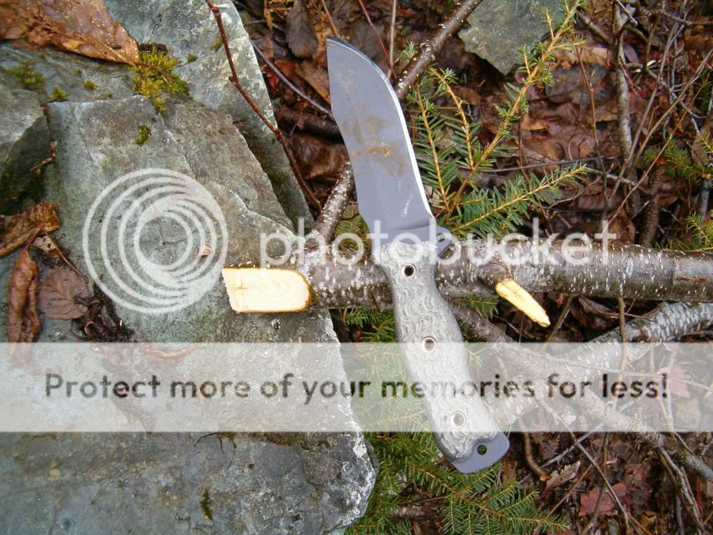

I can't show action shots of the BWM's and B11 in action, but what I can show is pics of the knives after they have been used extensively last fall, along with a few others. ;)
