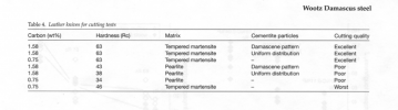

I think wootz was not a supersteel. I have made and studied wootz and published an article "Wootz Damascus steel of ancient Orient" in Scandinavian Journal of Metallurgy 33(2):92-97 (2004)
I tested knives for leather cutting. Here are my cutting test results "Damascene pattern" is carbide figures of wootz. According to my test results wootz was not better than 0.75% carbon steel. Hardness is crucial. It makes difference between excellent and poor cutting quality. Notice that pearlite with 34 Rc cuts better than tempered martensite with 46 Rc. Pearlite has small carbide lamellas which improve cutting performance. Many ancient blades had pearlitic structure. Screenshot from 2018-07-10 16-04-59.png
