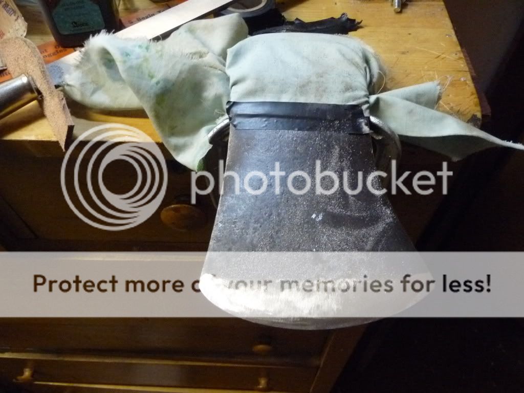

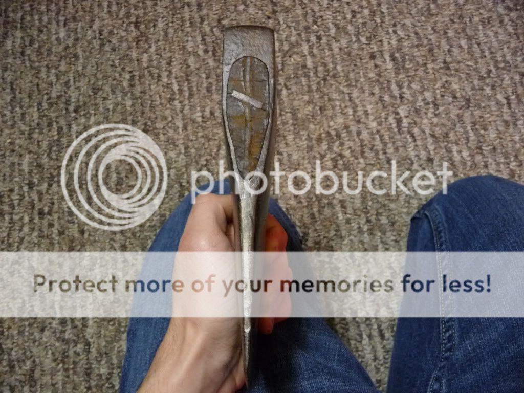

Personally, I've found that the vintage, single-bit heads I tend to run by most often on undisclosed bidding sites fit your bill. I believe most of them are considered "michigan" patterns like the head I have below (which has been restored and fitted onto a 32" straight handle) - it's relatively thin for a hardwood axe with bevels that help with chopping but the overall shape is somewhat convex so that it splits fairly easily. Give it a nice, relatively acute grind as pictured and does a pretty admirable job at both chopping and splitting given the right technique is employed
Generally, so long as you have an overall flat to convex shape and not a concave shape combined with a thin edge like on this GB Scandi pictured below, the axe is going to split wood pretty easily. This sort of axe is meant for softwoods and while it bites deep into softwood like nobody's business, splitting hardwood of a larger diameter is going to be a real pain.
**edit** one thing I also completely failed to bring up is the type of wood you plan to work with. If you think you'll mostly be working with soft wood, get the latter shape (thin and concave). It'll limb, fell and chop very well biting quite deep into the wood and should you need to split the wood, you can easily employ the technique shown 13m35s into this video to split rounds of softer wood using a thinner felling-type axes:
