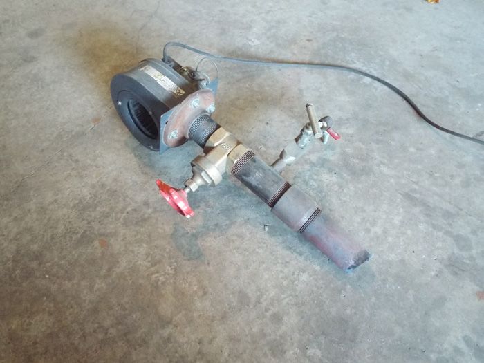

You can also extend that heating zone of the 12" by splitting it lengthwise and welding in a web.
Here's a 12" that I have used for about 7 years. I've made piles of Damascus with it, and it's still as good as the day I built it.
I use the same blower in both:
This is at welding heat:

And Karl, that is how every properly insulated and built forge should be. Thanks for sharing the pics...
