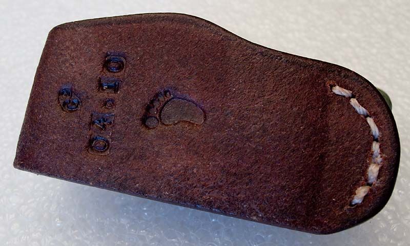

Howdy Gary. Nice work and excellent detail on that sheath. Could we get a picture of the backside? Sure would appreciate it.
Thanks, Ray
Thanks Ray, the sheath is made from one piece of leather, folder around
and then down behind the knife, sort of leather origami kinda thing.
I form it, dye, emboss, glue it together, stitch it up by hand, sewing down
to near the bottom and then I bring the stitches back up to the top side
and glue the folded down back side to make the belt loop, then I punch
holes around the bottom again, thread the one side of the thread back
through the hole to continue sewing around the bottom. Then I back stitch
a few stitches to lock the thread in place.
I have my G2 stamp, then the month and year and then my little Right footprint
just as a reminder to always start out on your right foot when you wear the knife ;)
