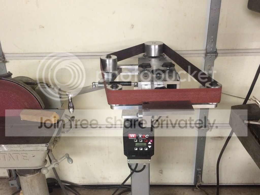

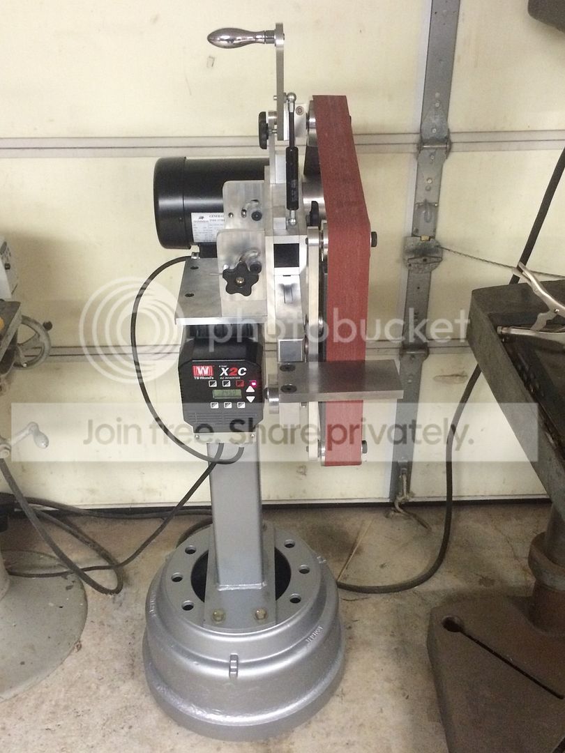

[video=youtube;IIqdNZaB-Uc]https://www.youtube.com/watch?v=IIqdNZaB-Uc[/video]Here is a not very good photo of my vertical/horizontal Polar Bear Forge grinder with a Travis Wuertz surface grinder adapted to fit. The Plywood is 3/4 inch laminated birch and the hinges are door hinges. The stop which holds the grinder level is a piece of Redwood 4x4 with a dowel pin in the base to keep it in the right place. The stand is a Harbor Freight Universal tool stand with some steel cross braces bolted on. I have been using it for over a year and it works great. Larry
Jonathan's is that a beauticians chair pedestal ? I have one I saved from the land fill years ago with similar thoughts in mind. hydraulics work but mine rotates with no stop. Chris
It's a barber's chair base. Mine doesn't rotate and I'm not sure what prevents that. The hydraulics slow me to lower the grinder for when I'd rather work sitting down, or kick it up for when I'm standing. I'm real pleased with it.

Not exactly what you were asking for but I built the rotate feature into the grinder I just built for myself.
However you design your base, I _strongly_ recommend that you put a _positive stop_ in the horizontal and vertical position. In other words, there should _not_ just be tightened knobs keeping your grinder from tipping over while you're grinding (and eating your face when it does). In addition to any tightened knobs (which can vibrate loose), you should have a pin or bolt or something to keep it from tipping to the other position, and this pin/bolt/whatever can be removed when you want to change positions (in addition to loosening any knobs). An extra second to switch positions could save your fingers/face.
