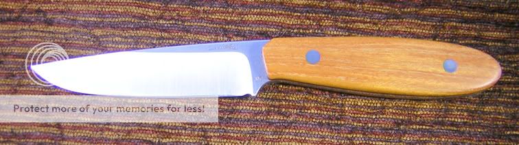

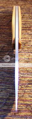

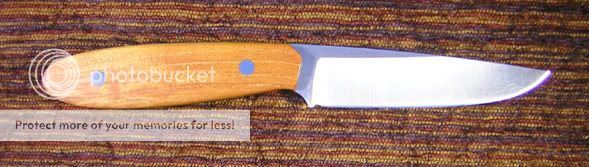

This was a special request, he wanted one that was quite thin. A lot of my personal knives are this way, but I've only ever sold one other that was this thin. It has a high hollow grind with the tangent of the grind about .100" above the edge. It measured just under .010" at the edge and it doesn't reach .020" until pretty far up there. So it is starting to get into the same neighborhood as a straight razor with a belly on it. I sharpened it to about 25 degrees total included angle. It measured HRC 62
Obviously it is relatively fragile and wouldn't work well as a general purpose knife, but that's not what it was made for.
To me, knives like this are a lot of fun to play with. You can shave your face with it without touching the skin. You can cleave a grape dropped onto the edge. You can wave it around and split oxygen atoms. ...Okay, maybe not that last one....

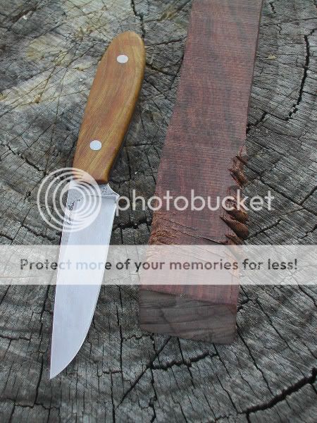

This knife, at HRC62, chopped up ironwood without chipping. But it did suffer edge roll.
