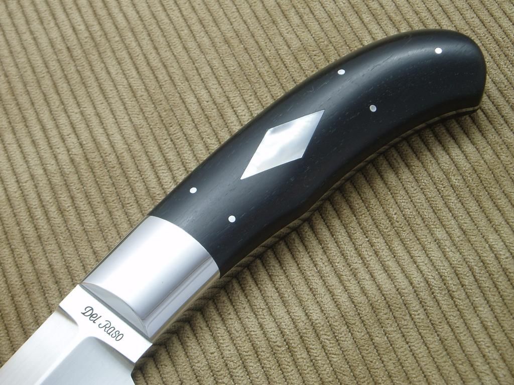

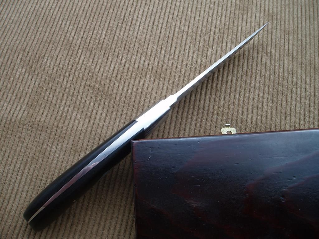

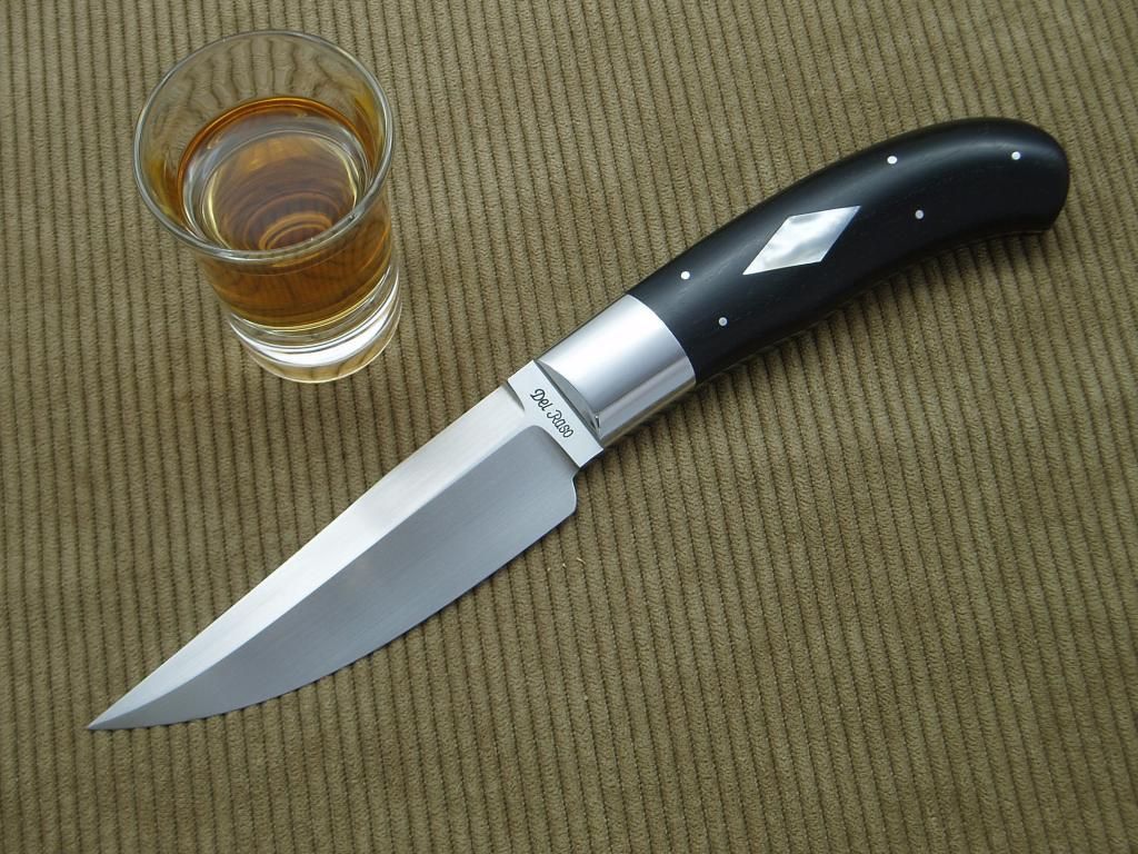

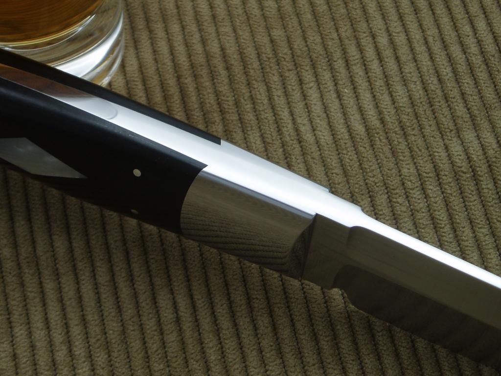

Just finished and ready to go to the Engraver. Double hollow ground ATS34 blade with false top edge, a full tapered tang, and satin finish. Dovetailed 416 stainless bolstered matched with woodwind grade African blackwood. Mop inlays have stunning figure that does not show in the pics.
OAL 8 3/4" X 4" cutting edge. Not quite San Francisco, but close. Hope you think so to.
THAT is a wonderful display of your talents.....really doesn't need any engraving, IMHO. ;)
Very nice! What are the essential qualities of a "dirk?" The double edge? Wider on one side of the grind, vs. a dagger with symmetrical double edges?
Beautiful work, and as mentioned above, it doesn't need any engraving.
Good question Jason, but I am not knowledgeable enough to answer. Having a clip point I couldn't call it a dagger and thought "dirk" which I interpret as a small fighter, is a better monica.

I don't always go for this general sort of knife, but man, this one really is nice. the lines are so clean, and the material is just right.
great work.
Very nice
Fantastic lines
Does not need engraved
Would like to see top sharp also
Joe I would normally grind the top edge much thinner, thin enough to sharpen. This piece will most likely be part of my stock for an up coming show. The restrictions in that Australian State are very restrictive of double edge knives, subsequently I left the edge thick enough to avoid any complications.
Also thanks to you and everyone who has posted the knife does not need engraving and presents well enough with out it.
