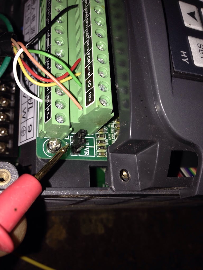

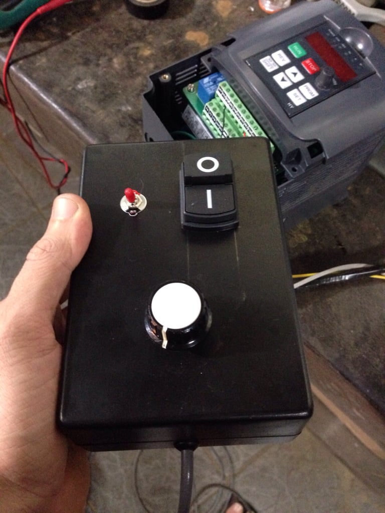

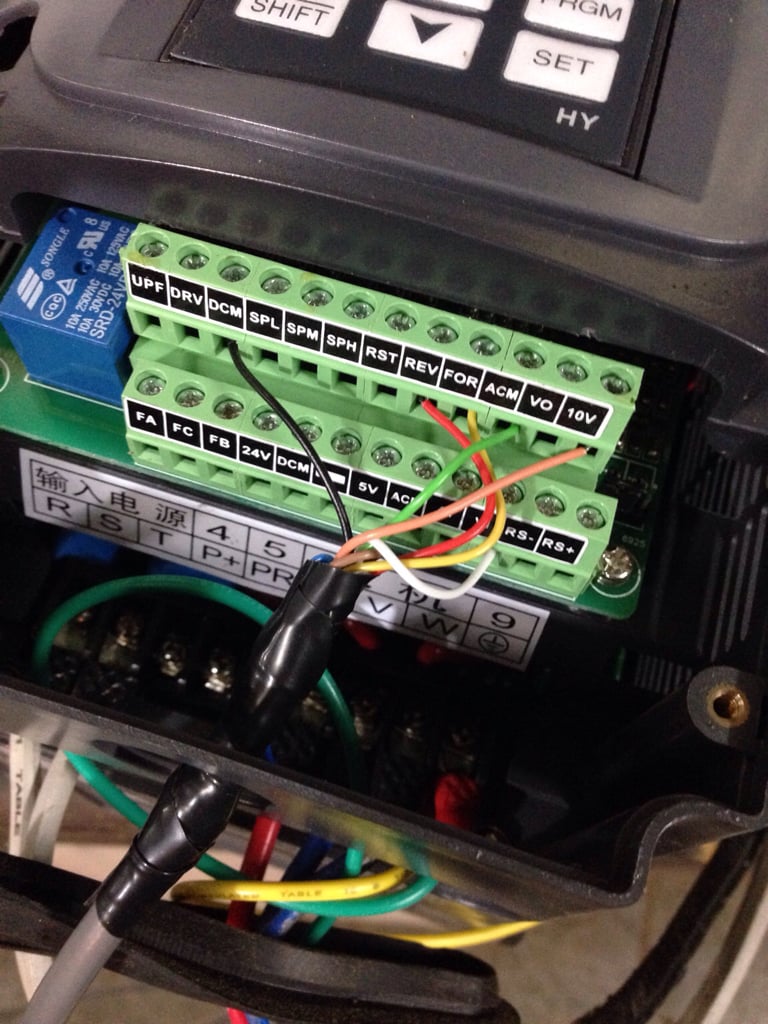

Ok this is going well...mostly! I've setup the external controller box with the On/Off switch, forward/reverse SPDT switch, and the potentiometer connected to a 12 foot lead of 8-stranded cable going from the box to the VFD.
The good news is, On/off and Forward/Reverse is working perfectly using the external controller!
Bad news is, potentiometer seems to have no control at the moment. I'm doing my best to troubleshoot it as best I can but can't seem to find where the issue is. All connections should be good, I've swapped the 1&3 connections on the Pot, tested for continuity, messed with the VFD parameters etc. No dice so far. I'll have to refer to the manual again, which means I'm in for a night of many, many wtf moments while deciphering poorly translated technical reference for something I have only a loose grasp on to begin with! Perhaps pics would help. I'll work on that :p

Actually, I think the pot is recommended to be 10kOhms, but I have found that anything from 2.2 kOhms to 10 kOhms will work on every VFD I've had. It is used as a Voltage divider in this application and therefore does not need to have an exact resistance value.
IIRC the external pot function had to be chosen on mine. I think there were 2 options, default being the up/down arrows and 2 for external pot.

I figured it out! After going through plenty of threads in the cnc and machinists forums I found a post where someone mentioned needing to change over a small jumper block next to the external connections terminals.
On mine it was to the right of the green terminal and allowed you to choose "vi" or "vr" via a small black jumper box (see photo below). Since my VFD already had a pot installed on the face of the control panel I think it was overriding my external pot until changing over the jumper pin to "vi".
Also shown is the current setup for the simple external control box. It works like a charm! 12 ft. cable lead so I can take it around to each of the machines.
For now I'm going to use the "plug" system despite the inconvenience factor and then tackle the "switch box" as a separate project in the near future.
Yeah man. The control box on a leash is the way, that's what I've had for a while and it is effective. IR remote would be cooler, but it would be a big PITA using an Arduino and logic circuits etc to make it work. Who's got time for that?
