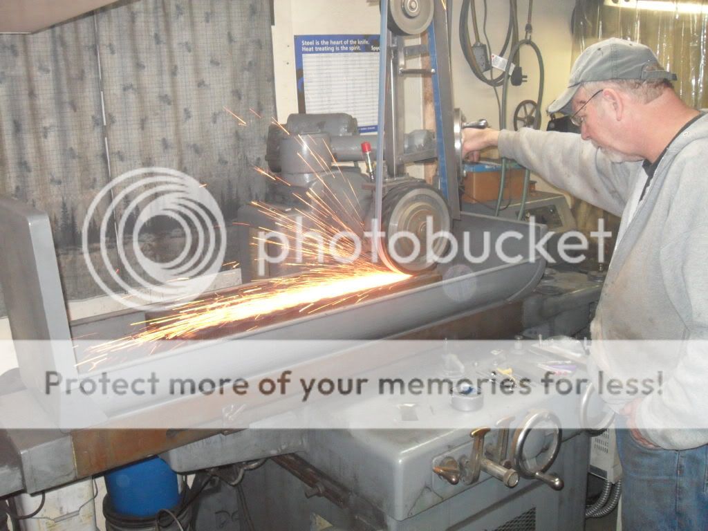

Heres an action shot of a friend of mine using one monster of a surface grinder, we did some turkish twist damascus that day! Anyhow take a close look and u can sneak a peek at the teco that has ran that machine unenclosed for he couldnt remember how long, i about crapped when i noticed the teco but has had no issues????
I could walk through the West Texas prairie holding a golf club up in a lightening storm without getting struck, but I'd hate to push my luck.
