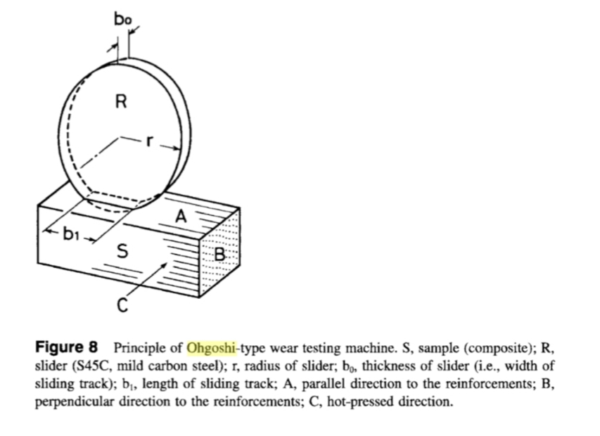

I was curious about the abrasion testing machine too, so I found this. Overall it was a nice read!
