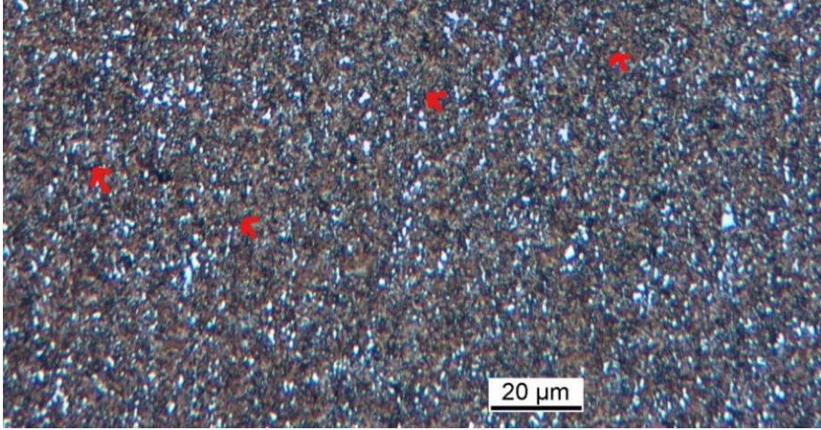

As for the carbides in T1 and T15 you get these, MC and M6C
[Sidi Lian 2015]
Diagrams on carbides found in HSS, W goes towards M6C, softer carbide than WC
M6C labeled as "Iron-Tungsten-Molybdenum Carbide in HSS" it's softer than WC
No WC phases in HSS, even in T1 with 18%wt W
