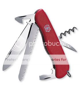

However the larger 111mm Victorinox SAKs were around with locking blades long before the line-lock versions were introduced -
for example
Victorinox Rucksack (US# 53661)
which utilizes what Victorinox calls "Large locking blade (button-lock)" - a sliding lock/blocker similar in concept to the old Gerber "lever-lock".
Then the liner-lock was introduced but with blades that only had a nail-nick - so were not one-handed -
eventually due to pressure Victorinox made some models with thumb-holes and called those knives one-handed - however the back-spring/slip-joint mechanism made opening one-handed pretty tough, as the OP observed -
why?
because the knife was originally designed as a slip-joint.
A slip joint stays open pretty well on its own without a lock (again as the OP observed) -
so the liner-lock is just an additional safety feature -
However Victorinox already had a locking mechanism that was more suitable for the knife - the "button lock".
Like I already said, a liner-lock on a slip-joint doesn't make much sense - when Victorinox already had a locking mechanism for that sized knife - PLUS it is a left-handed liner lock.
