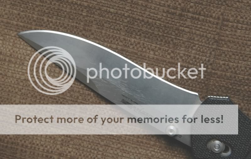

Here's a knife and a steel that people often claim are hard to sharpen, the BM710 in D2. I reprofiled the edge to somewhere between 12 and 15 degrees per side using sandpaper on a broom handle. Then polished it with a Spyderco medium then ultra-fine ceramic. I find D2 to be much more forgiving of occasional mistakes that might be made during sharpening and takes a fantastic edge.

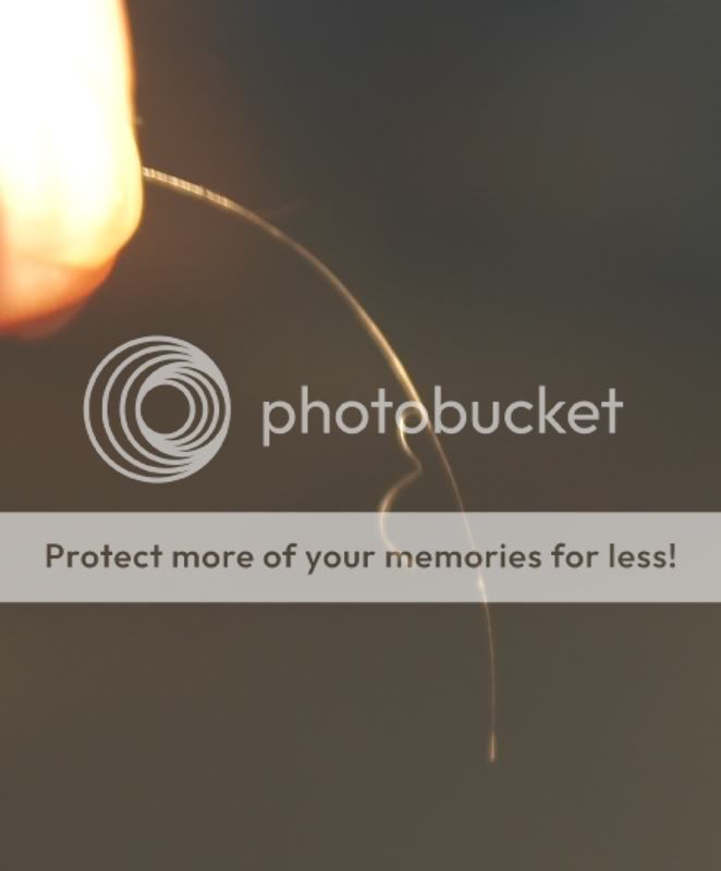

Ok, here's mine...
I use a 1000/3000 suehiro waterstone. When the knife doesn't shave arm hair any more, I take 2 minutes on the 1000 side, turn stone around and perhaps 1 minute there.
Then 40 or so strokes per side on newsprint with a bit of CrO laid flat on the table.
I guess I need a macro lens. Nozh, use this as you like. Your videos are great, perhaps I'll try diamond sometime. I like waterstones but they sure are messy.
