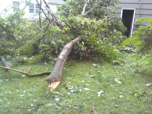

I hope to have a batch ready in a week or two at most, thanks for the interest. I'd hoped to make a few this weekend but a huge limb from my Norway Maple crashed right alongside my living room last night in a wind storm - ripped my electrical riser right off the house along with my cable - lucky it didn't flatten my living room with us inside!
Instant weekend project. The linemen fixed the power late last night in a warm downpour with heat lightning (those guys are great!). Along with my chainsaw, I'll be using my machete quite a bit today - sure am glad I have a Washboard to keep it razor sharp! ;)

Thanks, yeah - could've been much worse. High winds came up out of nowhere, "this isn't good" I'm thinking, then a real loud CRACK. I went to the window and saw it land right alongside our living room addition, maybe 8 ft away. Lights didn't even flicker as the electrical got tore off the house. Looking up into the canopy I can't figure out how it managed to miss the house. Put a dent in the top of my gas grill, didn't even rip the gutter off.

Actually, I left the skeleton from the largest limb so the kids could play on it - had to do a bunch of leveling before I was comfortable with that, but very stable. Once they get bored, it'll go with the rest - more firewood! Which reminds me, I was supposed to finish rebuilding the cap on my chimney, and now I have a bunch of holes in my siding to fix...
Here's some pics - included a pic of a Washboard so maybe this doesn't count as a total hijack?
