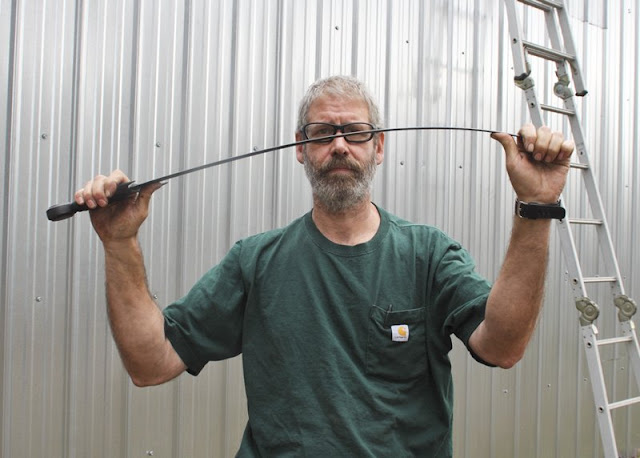

Scott spent last week taking a sword class with Sam Salvati and several friends. Vigilante - an Old World sword with New World flair - was born in that class. Scott still needs to figure out what type of permanent handle the sword will get, but she's nearly finished.
Steel: Hand-Forged 1084
Finish: Draw filed and Parkerized
Overall Length: 35.75 inches
Blade Length: 29.25
Handle: TBD
Scott added a temporary handle for pictures and testing. Vigilante will ultimately get either an all wire-wrapped handle or one with wire over black leather.

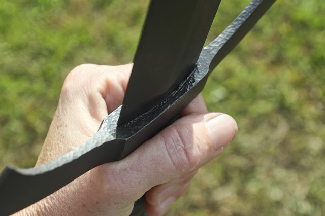

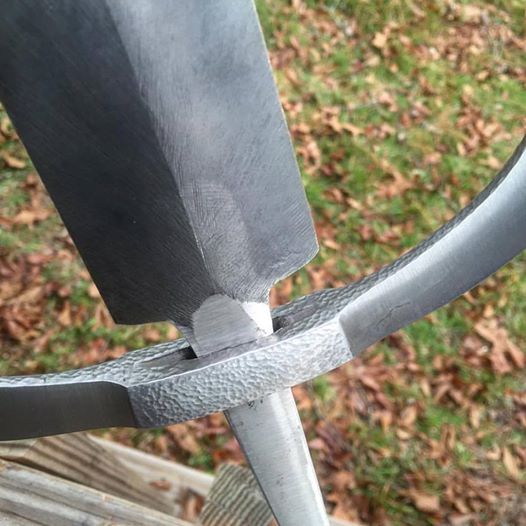

Scott hand-forged the blade out of 1084 and peened the mild-steel guard in place. He added additional peen marks for a decorative effect.

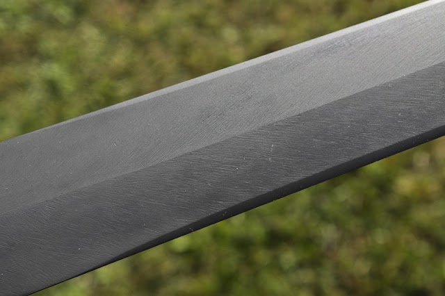

The entire blade was also draw-filed by hand (grinding blades was prohibited), and Scott decided draw-filing metal is Medieval form of torture.

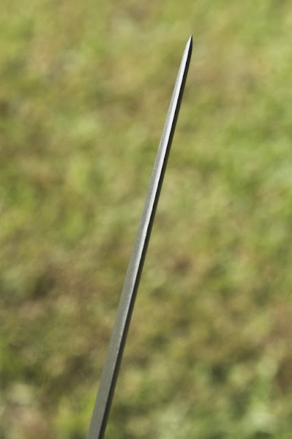

Check out the bar stock vs. the forged blade.

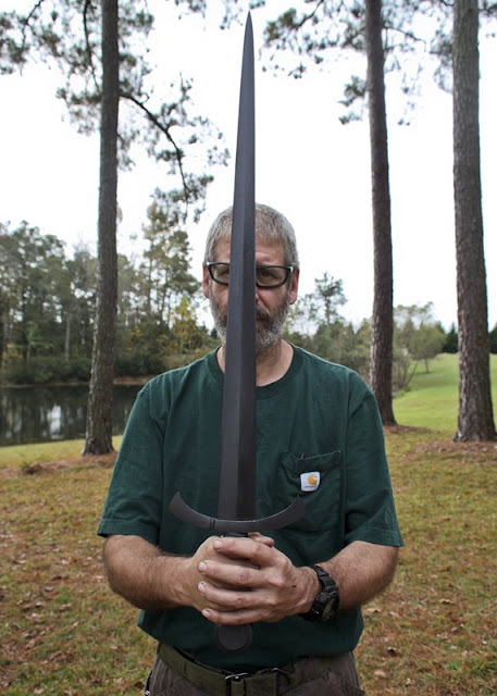

With guard and pommel added, the entire sword weighed only 2 lbs 11 oz.
Scott chose to Parkerize Vigilante, which helped protect the blade when testing on pineapples.

Draw filing is cathartic. Forces you to slow down and feel the agony. :D
