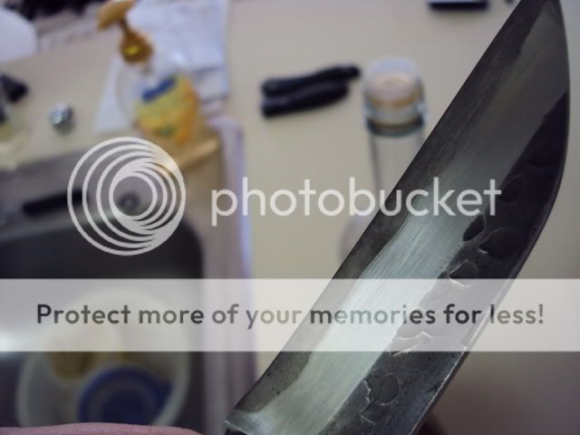

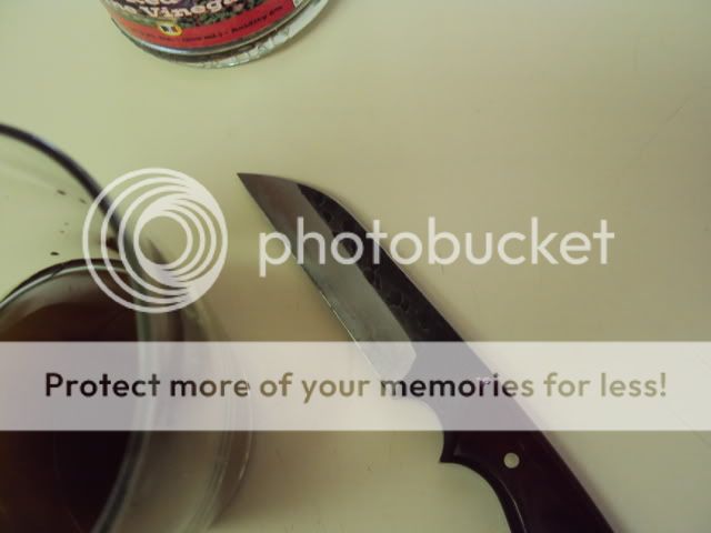

So i did the patina thing. long story short, after several attempts with out getting the result I wanted, my last try was wrapping a vinegar soaked towel around the blade. not what I wanted, but I like it none the less. I also did a small hatchet.

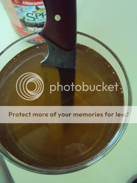

Nice job, a patina is a good touch on most any blade (if only to prevent some rust). If you weren't totally pleased with the vinegar, try leaving it in a glass of lemon juice next time. It will leave a slightly deeper and more even patina.

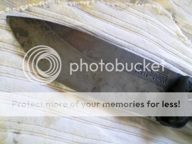

It's really funny that you just posted this, because all week, I have been considering trying it on one of my BK2's. I will give the lemon juice a shot and post pictures.
I wonder if the 1095CV is a little more resistant to the patina because of the added chromium...
Anyway, first thing's first: I have to get the coating off.

Actually, yellow mustard(French's) was my first step, it left a really dark circle around the edges, but nothing in the center of the blotches.(i also tried a tiger stripe ala ZT/Strider) the mustard was not setting dark enough, hence why i tried the vinegar rag, after some use I plan on applying another patine, using lemon/lime juice. and more vinegar.
And as to the removal process, I did not use any paint stripper, i used a razor blade, flat scrapped off the paint, the used a medium grit sand paper.

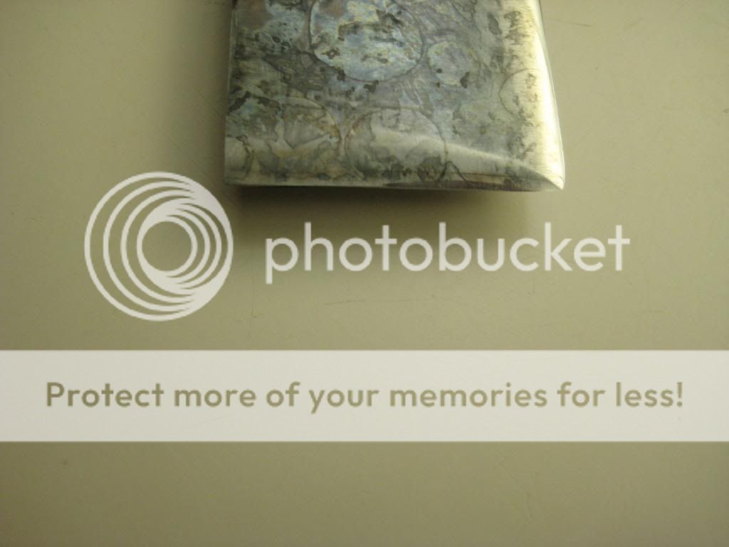

Here is a really quick Patina I did a while ago with mustard.
here it is after a few more layers, and a quick polish. The etch is deep enough that even with a quick polish, you can still see the lines.
This was from leaving lines of mustard on for a little while.
If you leave it on for hours, it will actually etch into the metal and leave a wavy surface, almost like damascus.
I have seen makers actually make carbon steel look like true damascus, or other interesting "rain drop patterns"
You can make different patters. Just leave it on for less time, and it will be shallow enough to just buff off with buffing compound (stropping compound and a strop will do this fine).
When you make a pattern you like you can try again and make it deeper if you want.
One thing I have had alot of luck with, and what I do to all my psk style tin knives. Take a skillet, place blade in it, cover the blade with vinegar, usualy a small bottle will cover it. Then add 1 tbls salt and turn the stove on low-medium.
now take the blade out. Add the blade back when the salt is dissolved and the mix is hot. keep it in for about 5 minutes, and it produces a very uniform, grey patina. I love the look, almost like it was blued.
