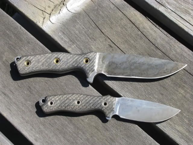

Here is a really quick Patina I did a while ago with mustard.

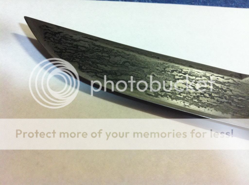

here it is after a few more layers, and a quick polish. The etch is deep enough that even with a quick polish, you can still see the lines.
This was from leaving lines of mustard on for a little while.
If you leave it on for hours, it will actually etch into the metal and leave a wavy surface, almost like damascus.
I have seen makers actually make carbon steel look like true damascus, or other interesting "rain drop patterns"
You can make different patters. Just leave it on for less time, and it will be shallow enough to just buff off with buffing compound (stropping compound and a strop will do this fine).
When you make a pattern you like you can try again and make it deeper if you want.
