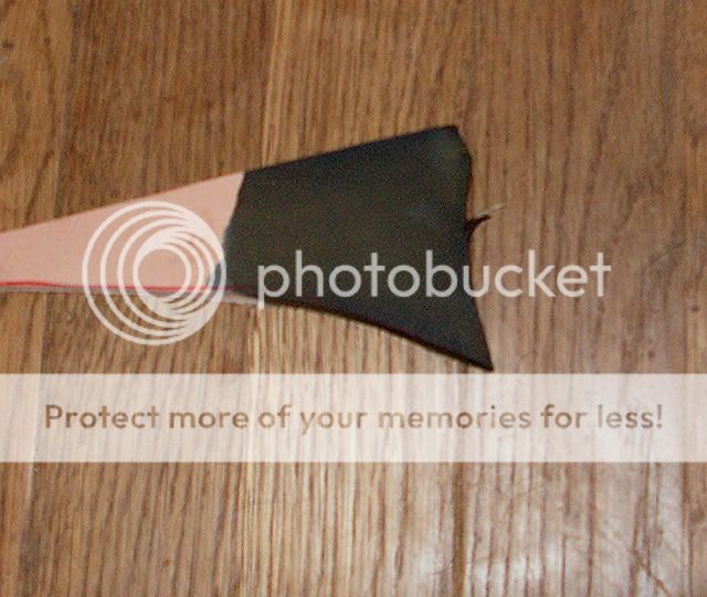

A scrap of veg-tan
This is 5 minutes later. Gets darker and less purple colored, more of a deep charcoal gray
When it gets to the color you like, neutralize it with baking soda mixed with water and oil it.

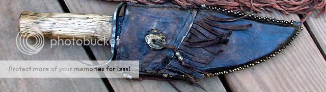

Pullrich, think big cow. The big ones are fun, you really have to get creative or you have a side in one sheath. Someone roll 1975 around on the ground. Vinageroon never fails to amaze me, here is one I'm working on now. This is with no finish yet, just dye.
It gets richer with finish.I have to build me a photo box......Randy
