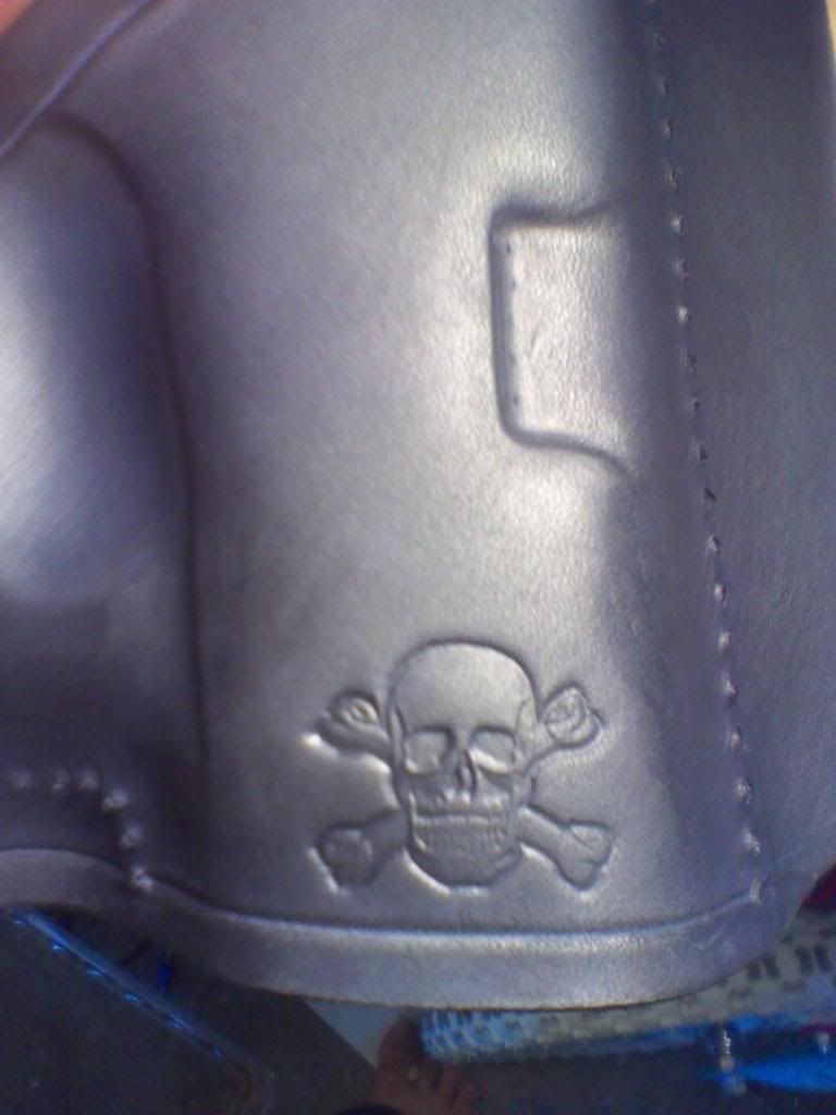

Okay, I brewed up a new batch of the good stuff, just went 8 days and it was working fine. I didnt bother straining it just swabbed it on this axe cover. Hope you like. More detail over in the excellent axe and tomahawk forums, moding CS trailhawk thread.
Today I learned that it is important to store your vinegaroon in a plastic or other non-metal container. Eagerly went out to the shed to die my latest hawk sheathe only to find that the tin can I was brewing it in had corroded and sprung leaks in the bottom. Lesson learned. New batch perking in the apple cider vinegar jug.
Also, make sure you have a "pressure release" hole, or a lid that will allow pressure to go. I forgot to poke a hole in a new batch, and the pressure ballooned the bottom enough to tip it over, then it finally popped the seal......on the floor of my garage!
White vinegar is the most acidic, then apple cider, red wine, champagne, rice wine. Heat will speed up the reaction, whether you are forcing a patina on a blade or dissolving metal in acid.
this is the color i get after a few coats of oil. don't buy the expensive "leather" oils on the market. olive oil works great, and has for centuries. :)
