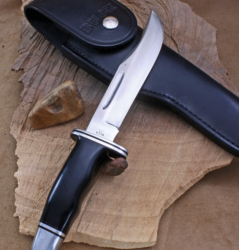

This 119 has one Micarta spacer in the guard and two Micarta spacers in the pommel. Based on the number of spacers and sheath style, what is the date range of this one?
The transition time from four to two spacer was 1981.
1980 they still had the four spacer. In the early 1981 Buck
build the three spacer 119. Later in the year they killed
the second spacer at the pommel.
Hope that helps. :)

Still confused. Here are a few 119s with old style flap sheaths that I just pulled off the Bay and they all only have 3 spacers.

Well for a minute there I was excited. I thought my only 119 was a three spacer but it's a four spacer but tang is read tip down.
300
Here's a photo of my only 119. Will take some better ones and use them in Sunday Picture Show.
Well for a minute there I was excited. I thought my only 119 was a three spacer but it's a four spacer but tang is read tip down. 300
Still just as rare.

I think Haebbie and Sky has it accurate. I have the exact knife TAH & 300 bring up. In TAH's post 11 and 300's post 14. It has a thick primary edge and a snoopy sheath, with 3 spacers and curvy tip. 300 was lucky enough to get a 119 that someone positioned the stamp wrong in the holder. I've seen those. Wonder how many others are out there. I really like that style blade and tip on the 119 so, I kept mine and carry it. I've given some thought toward thinning my 119 blade down to make it a better cutter. But I'd rather keep it the way it came out of Buck's factory. DM
