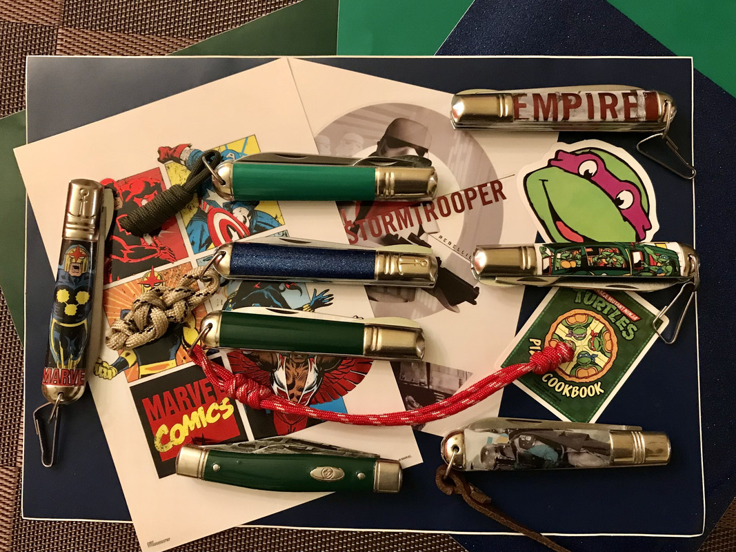

I have had some success re-covering shell construction knives using laptop stickers and permanent self-adhesive vinyl lettering material (you can get it at the craft store).
The stickers work well if you can tuck the edges into the gap between the stamped metal handles and the liners. The vinyl lettering sheets are the best, because even if you can’t tuck the edges in, it will stick very well. It will peel off cleanly if you don’t like it, but you have to work at it a bit to get it off.
I have carried the light green one around some in my pocket with my keys and such, and it shows no sign of coming loose:
(The Imperial serpentine jack looks a little rough because I tried to cut out the vinyl around the fake shield and pins and did a lousy job. As with any type of adhesive, I usually wind up wearing more of it than I manage to apply to the intended surface :rolleyes:)

Those look great. I never thought of laptop decals or the vinyl letter materials. Makes me wonder if skateboard deck tape would work, or do you think that would be too rough on the hands?
Thanks :D
I imagine skateboard deck tape may catch on the material inside of your pocket and make it difficult to get out.
