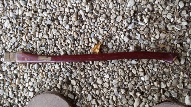

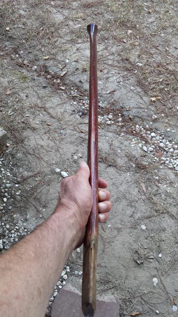

I bought this for my Craftsman double oval but couldn't see the warp in the pics the guy posted. 36" Link handle. Would you hang it or keep it for a pattern handle? It will be a user. Thanks
It's hard to see in the pics, it's more of a twist. The first picture shows it best, so I wouldn't know how to clamp it to untwist. My apologies if my original post is misleading.
I would just steam or heat it, then clamp it to a bench or board for a few days. Sometimes you need to over correct.

It's otherwise a very nice-looking, slim profile and grain correct piece of wood. You'd be surprised at how many slightly-crooked axes are actually in use without any complaints from their users. If you can figure out a way to thoroughly steam the section that needs twisting or straightening (tinfoil cover wrap over a pot of boiling water, for instance) I would think a concoction of clamps, hold-downs etc would remedy the problem. Perfection is not really a necessity for a user.

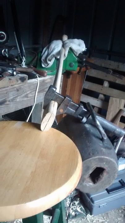

A fella recently showed an untwisting method on another website. Basically he clamped one end in a vise and put a big old monkey wrench on the other end. He hung weight on the monkey wrench to supply the twisting force and left it for a couple days. I was skeptical because he hadn't used steam but he said it worked at least to some degree.

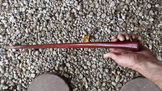

Apparently someone used it awhile, but no telling if the twist/warping occurred before or after. In this case I'm just looking for functional, but I really like the slim profile and flared foot.

Correcting that handle would be a 2 step process. First, steam or heat, then clamp to straighten. Then, repeat with heat to correct the twist. Sometimes the first step will remove most of twist.
That would be pretty easy to straighten with steam. Put it over a pot of boiling water for 45 minutes or so and then take it slightly past straight on a jig or with some clamps on a work bench. It will have some spring back when you unclamp it. Leave it clamped over night. I do a lot of steam and heat bending. Its amazing how easy wood will bend when you get it to the right temperature.

Even 20 minutes will do the job. It's the temperature more than the steam that softens the wood. Native Americans used to straighten arrow shafts over a fire with a special bending stick. No steam used at all. But steam transfers the heat quicker.
I use a roasting pan on the stove because it's wider and heats a longer section of the handle.

I have used a similar method but with a pipe wrench and a cord doubled though the end of the pipe wrench handle that I twist up with a stick for the right amount of correction. I think like you that with out heat there is little chance of long term success,

I use a similar method as the wrench with the weights when I remove the twist from a bow limb. I use a heat gun unless its a major bend. When it gets to the right temperature it will start to untwist due to the weight hanging from it.
