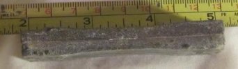

Edge view of 2 grit stone - well used.
Width view - about 7/8 inches wide.

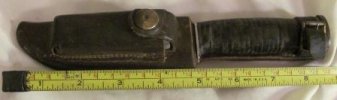

Orca -
I just acquired a 5" version of the 598 WITH the original sheath. Posting it here so you can see what it looks like. Not in real good shape, but I can use it as a pattern to make one for it, and the other one I have.
