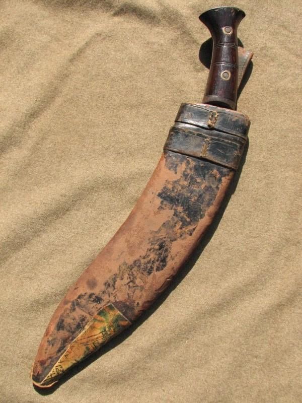

I scored a vintage WW II khukuri the othe day, pictured here with scabbard. It's a practical length (17") and weight (23oz). Feels great in the hand. The edge shows signs of usage sometime in the past, but the blade is in great condition; the photos don't do it justice.
My question is about the scabbard. It fits the khukuri perfectly and the leather has no deep splits or cracks, but the original leather was coated with some kind of shiny black lacquer (or maybe clear lacquer over black dye), and the black stuff is flaking off in spots. You can see it in the photos, expecially if you inflate the pictures. The leather seems to be brown (probably its natural color) under the black coating.
I'd like to know a good way to preserve the leather. My first thought was to apply some leather conditioner; I have a bottle of Lexol handy. But that might not sink in, due to the existing shiny black coat, and it might not stop the "flaking." My second thought was to coat the whole scabbard with some kind of durable clear protection, such as varethane.
The scabbard has a frog (not a belt hanger, but it includes slots for karda and chakma) that seems to be frozen on. Looks like the lacquer was applied over everything, which is probably why the scabbard has not fallen apart after 70 years.
I don't want to do major surgery like removing the existing black coat. The flaking problem is not bad enough justify that, and I might do more harm than good.

Your best bet on this one is to do nothing.
Once the hide is alligatored like in your pictures it's pretty much a lost cause to try to do much more than prevent in from falling apart.
The black part could be the dye and/or polish used to blacken the sheath, or it could be the actual black leather skin.
Once they reach this state the two are pretty much inseparable. If you remove the top coat, you will likely also be removing the skin of the hide, leaving the hardened pulp of the leather behind. this likely will not take to dye well and will never look the same as a scabbard should.
You could re-apply the lacquer or varnish already used, but you would have to figure out what was used.
You could apply something else instead, but only time will tell if that decision is a good idea or not.

This knife feels so good in the hand that I can't just store it away. Upon closer examination, I noticed a slight gap between one of the scales and the tang, so you can see all the way through when you hold it up to the light at just the right angle. The scales are completely solid and tight because of the pins, but I didn't like the gap. For one thing, it lets moisture inside to corrode the tang. So I taped off the handle, squeezed in some Devcon two-ton epoxy, and sanded it down. Problem solved. I also filed a bit of steel off the butt cap, which was protruding due to shrinkage of the wood. Remarkably little shrinkage, given that this knife is about 70 years old. Having started what amounts to a restoration, I plan to do some more work on the handle: sand, polish and several coats of tung oil.
The scabbard is another matter. Many good ideas in the replies to my original question. Some of them have been rendered moot because the black top coat has been flaking off by the hour. Mostly because I held the scabbard in one hand while doing the abovementioned work on the handle. At this point the proposal to "do nothing" is no longer an option.
The top coat appears to be some kind of black paint. I've been coaxing it off using the sharp karda that came with the knife. The good news is that the brown leather underneath seems to be in decent shape, though very dry. So my plan now is to try to get all the black stuff off, then apply several coats of leather conditioner. I did lose the "frog" portion that can be seen in the two photos. It was in much worse shape than the main scabbard, and was pretty much held together by the black paint. That's no great loss.
I'll post another picture or two while the scabbard is still halfway "peeled". Hopefully this will turn out well. If not, I'll either make a wooden scabbard or commission a scabbard from one of our talented forumites.

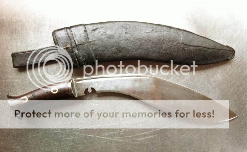

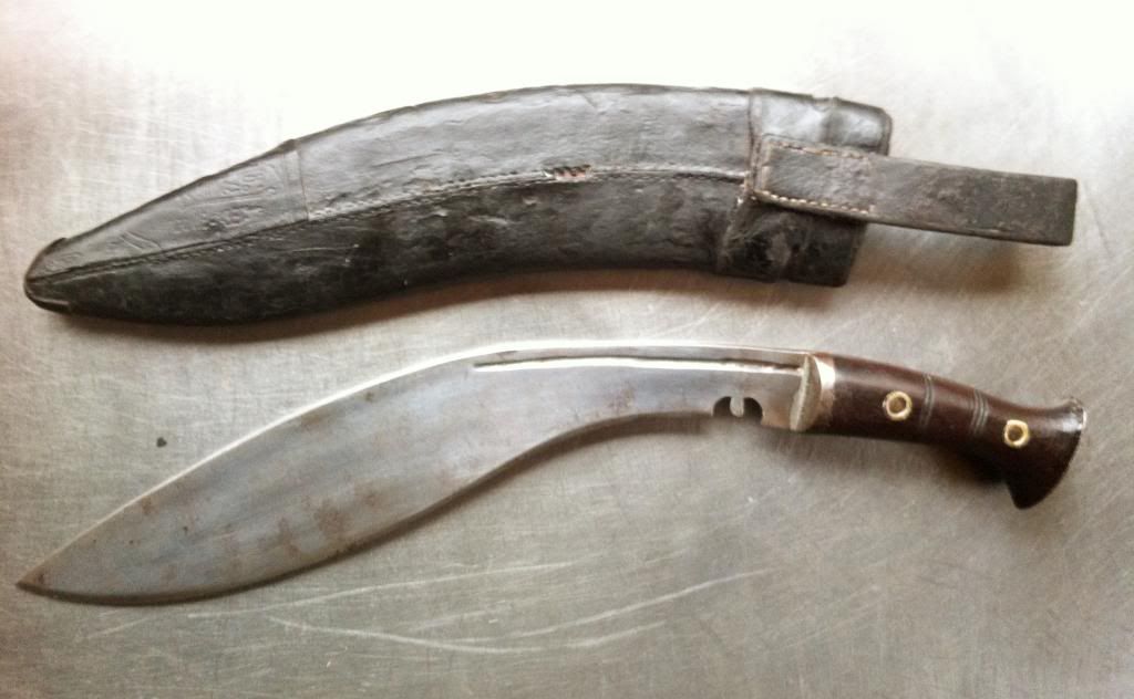

I had almost exactly the same quandary myself. I bought a MKII in an almost identical scabbard. The previous owner had attempted to repair the old damaged scabbard and had started removing the black topcoat. However they did more harm than good, stripping patches of top skin away and revealing the dry crumbly under leather. This is what it looked like when I got hold of it:
I felt that it would just make things worse if I continued with the stripping process, so i just opted for a fresh coat of leather dye and then a light covering of dubbin. The scabbard is a manky old thing and never going to be pretty, but I think it looks better now than when I got it:

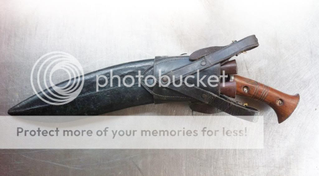

As a side note, MKII came in black scabbards too. My M43 stamped MKII has a very nice black scabbard:
