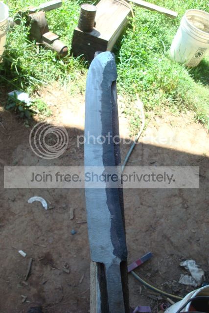

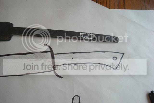

Here's where I am so far. I have the sword forged to shape, and I think I know my plan for the handle and fittings, but wanted to get some opinons on it.

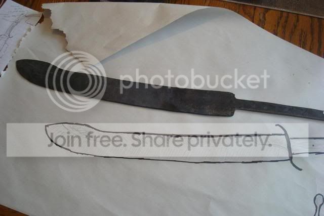

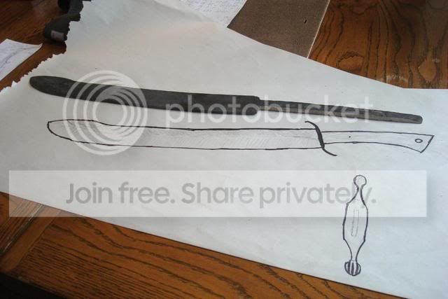

The rough forged blade beside my drawing. Down in the corner is my ugly rendition of my guard idea.
My basic idea is a clamshell style guard, from wrought, and a walnut handle. With a stainless pin and a stainless thong tube.
I have yet to decide if I want to do a partial tang or a through tang, thoughts? (you'll notice, I left the tang big enough too do either).
For the guard I'm thinking a shell guard (as mentioned before) similar to the guards on these two. I'm thinking that the shell would go with the cutlass like look the blade has - link1 link2
What do you guys think? What would you do or change?

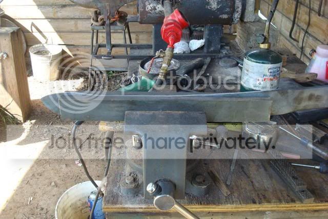

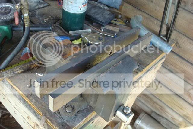

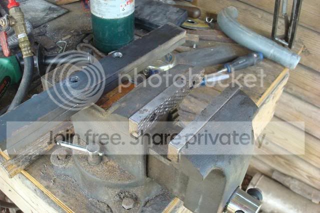

While I'm at it, I thought I'd show this. After forging the largest blade I've ever done, I found that I needed to straighten it. Typically I use my 4 1/2" shop vise to help straighten out a knife, but this sword was too long for that too help at all. So, I took some heavy bar and made new longer jaws.
Normal jaws.
New 12" jaws.
In use, I still had to tweak it after this, as the distal taper wouldn't let this straighten it all the way, but it helped a lot.
Get three cylinder magnets to set on those jaws in the places needed to take out bends/warp.

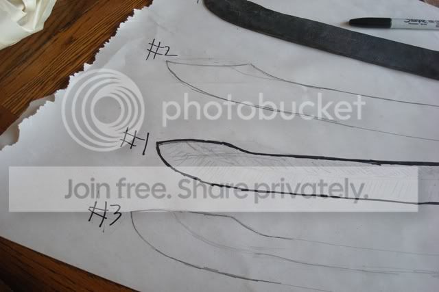

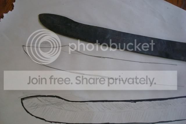

Well, I don't know about ya'll, but the tip of this blade just doesn't feel right to me. So last night I was talking it over with my dad, and sketching out ideas. So now I think I'm gonna reforge the end to look like this new drawing.
What do you guys think of the new possible design? does it look better, or seem to overstated.

This is my personal preference, but I would put on some Osage Orange. this knife just begs for a nice straight grain wood. Also, I like the tip the way it is. it looks to me as though the sketched tip might be just a bit fragile for the intended use of this knife. Just thoughts.
I agree with the geek on the tip. Maybe just a conventional spear point will work if you don't like what you have now. ??
Okay, I've been thinking about ya'lls thoughts on the new tip. And I agree, it could make it weaker. So I've redrawn it (again). And I think this new one is what I'm gonna do, all I really changed was pulled the hump farther back, straightened the edge, and added a slight radius.
What do you think of #3?
#3 of the options given. #2 just looks too....phallic.
