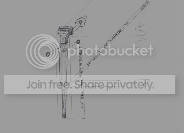

Sam, years ago my Dad had a post vise in his shop. It was mounted to a wooden work bench ( not you average bench, a beast that was rock solid). Where he had attached to post vise the mount he made acted as a post anvil as well as its anchor point to the bench.
Not content that there was no movement when he really wanted to crank down on the vice or needed the vice in bending metal he made a long threaded rod out of 1" diameter shaft, that mounted to the mounting back plate, that mounted to the vice. The rod was long enough to traverse through the width of the bench and through the exterior wall and tightened down with a huge washer and nut to mount down both vice and bench as one solid piece tied into the wall.
The post vice was one of those that had the 1"+ handle on it and I remember as a kid using a cheater pipe on the handle to crank it down sometimes and that handle has never been bent! Needles to say when something was clamped into it and cranked down it was their till you got ready to turn it loose. It got sold while I was in the Army and my folks health had gotten bad enough they needed to sell and move off the farm into town! I think about it and my Dad's shop often!:D

Yeah,Sam here is a slightly better explanation of what I was talking about!, perhaps I didn't explain that too well.
My father had done basically the same thing you are talking about to lock his vice down. The vice was mounted to the heavy bench by the mounting plate and he had put a solid chunk of an old drive shaft up through the mounting bracket and the bench to act as a post anvil so he could beat on it instead of the jaws of the vice. The brace was attached to leg below the mounting plate, there was no plate to stand on!
OK here is a very crude drawing of how the one I am speaking of was mounted up! I hope this will show up!
The bench like I said was a monster and had 6x6's for legs and full 2x4' laminated together for a top. So between the shear weight of the bench and the fact he tied the whole thing to a exterior wall it was virtually unmovable. The bar he added up through the bench was welded into the top of the mounting bracket and acted as his post anvil. Could be a little awkward to use at times due to the fact is sit behind the vice! The heavy hooked bar tied the whole thing together to be one of the solidest units I have ever seen. Plus that was one of the heaviest post vices I have ever seen. Like I said the handle was at least 1" and may have been 1 1/4" in diameter.
Dixie
WOW that's about as solid a mount as I ever could think of! Thanks for the drawing. Must of been a motha of a vise!!!
