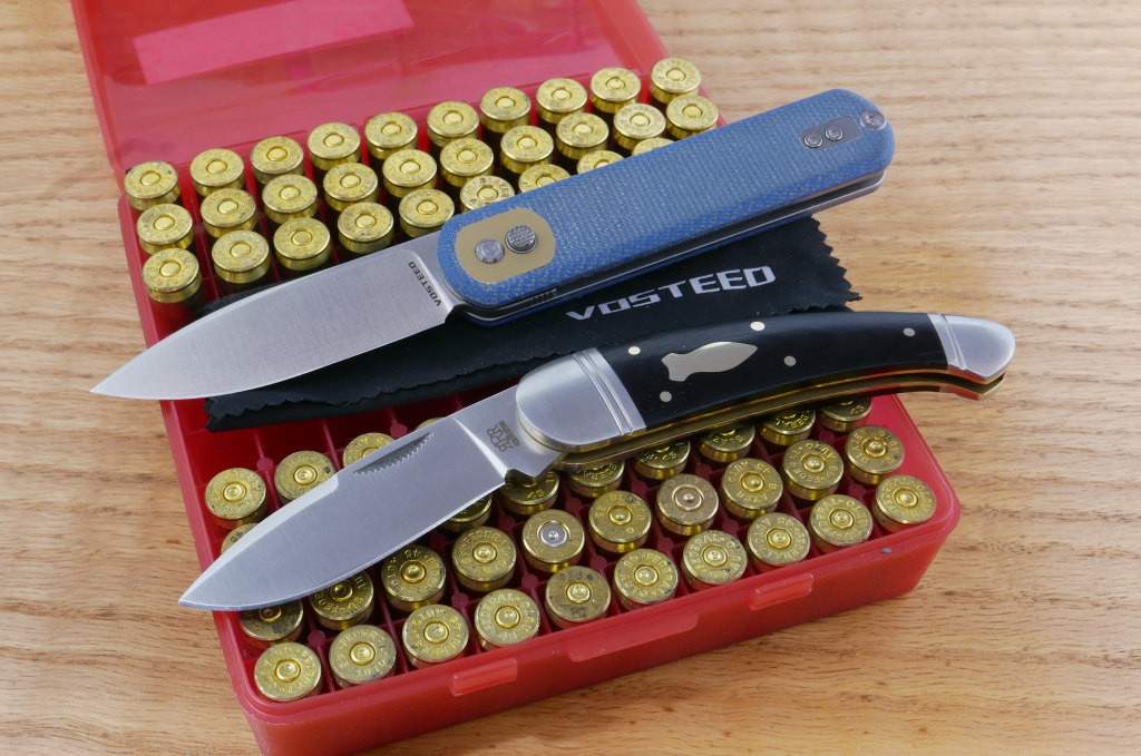

Is that top liner lock basically a button operated compression lock? From what I see in the photos on their website it looks similar.
Edit to add…
I found a disassembly video. It is a compression lock and the only difference is there is an extra pin. The liner wedges between a pin and the blade tang but theres a second pin that is the blade stop
