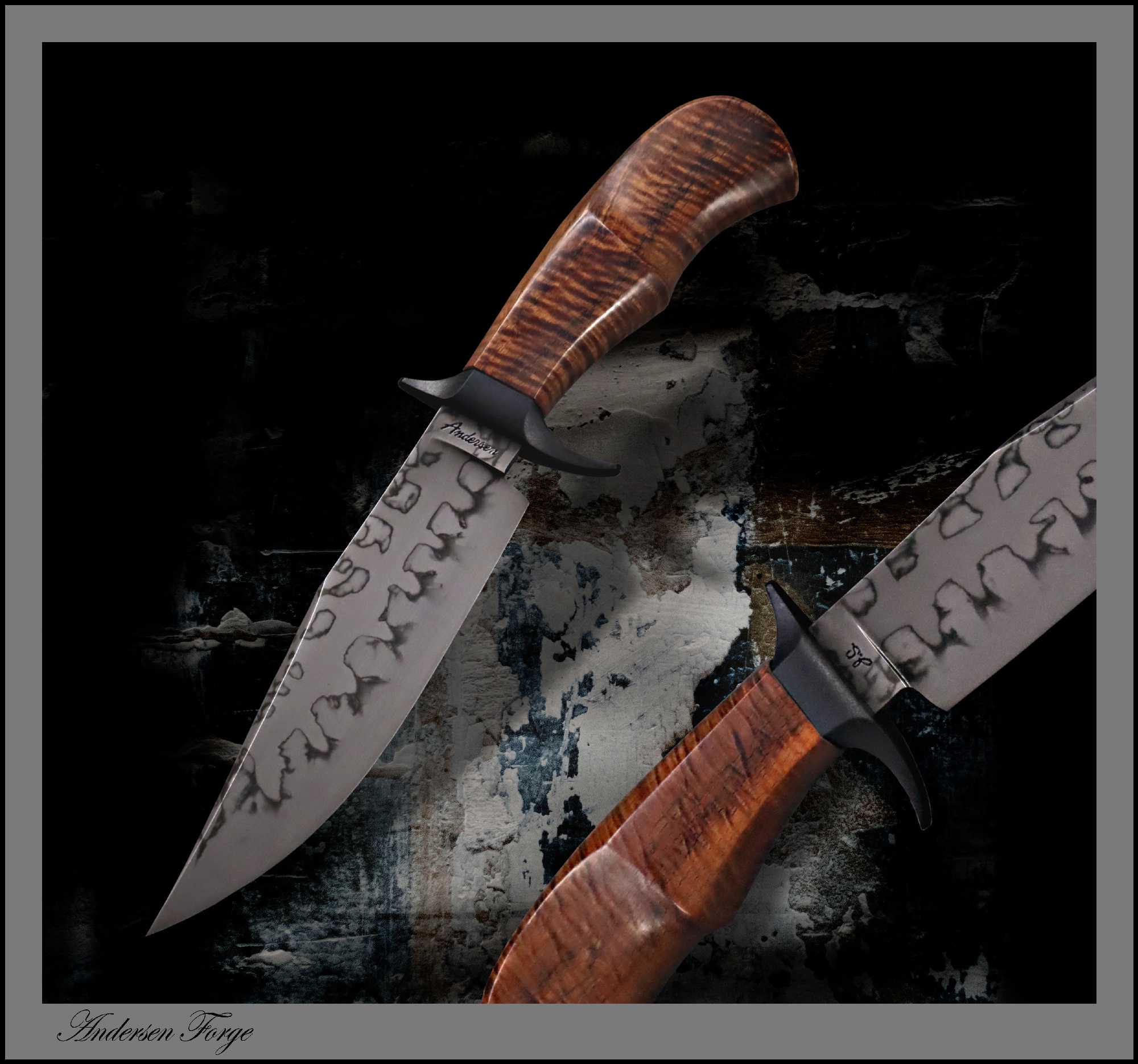

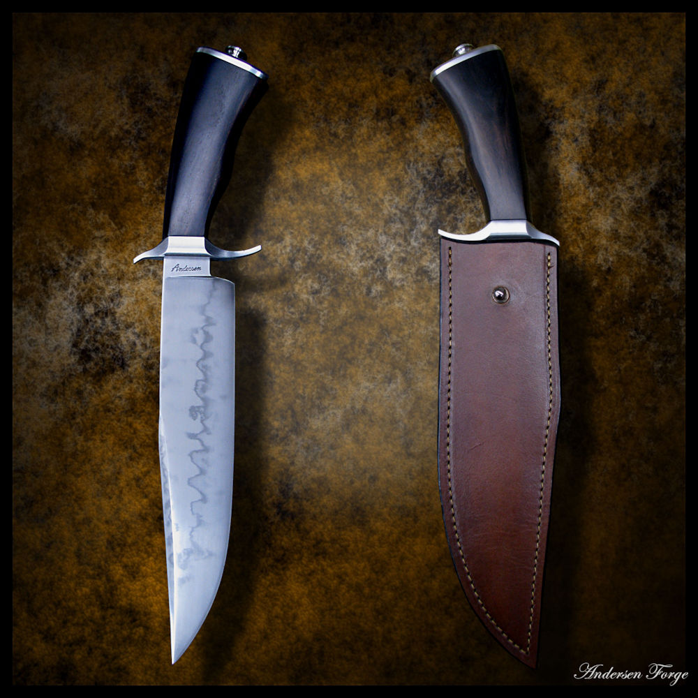

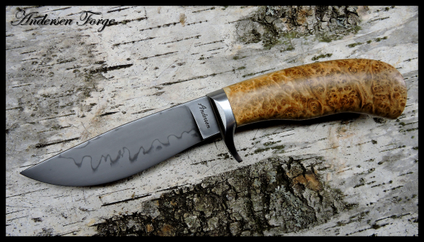

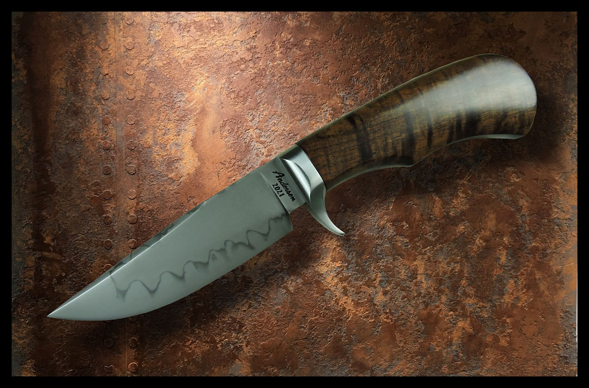

This is one I just did in DH III W2.
You might be amazed at how close to that you can get with W1. I don't think folks give W1 enough credit.

My post was mostly about giving W1 a try. If a person is seeking hamons - as is the OP - W1 is under valued. It will be nearly as nice as the W2 photo I posted. I used that photo as an example.
These are W1 from Fastenal.
