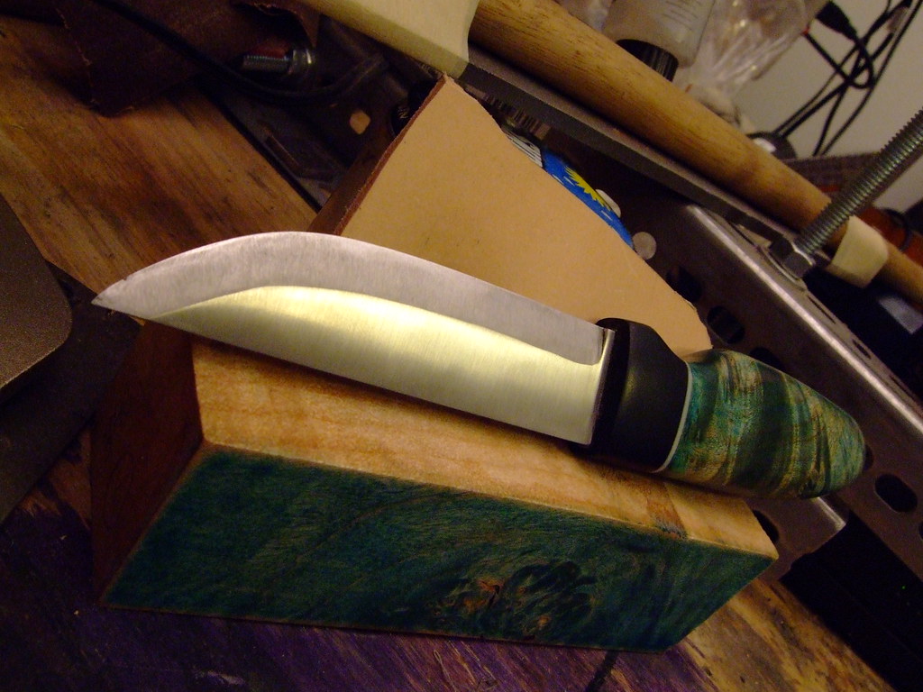

I finished the basic shaping tonight. Here is how I arrived at this handle shape: I started out with a simple ovalized barrel with palm swell.

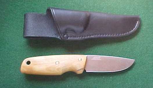

The more I handled it, the more I thought there was just too much width at the front. So I decided to cut in that finger notch. I was aware that there were some Scandinavian knives with finger notches (see EKA H8 pictured here, from www.ragweedforge.com )
The notch made it much more comfortable, too.
Then I worked on the shape some more, until I thought it was about as symmetrical and comfortable as I could get it.

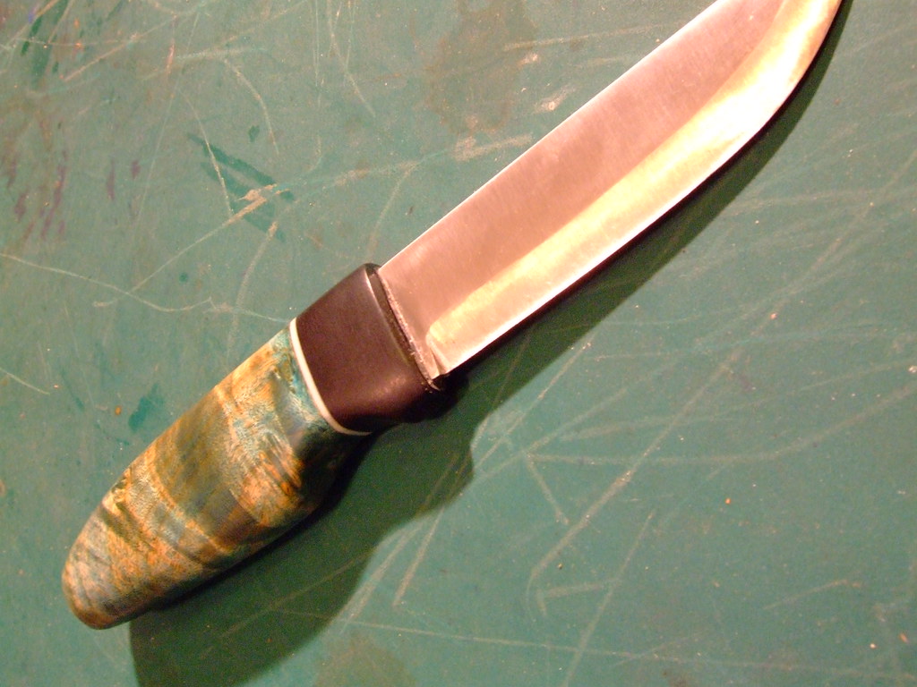

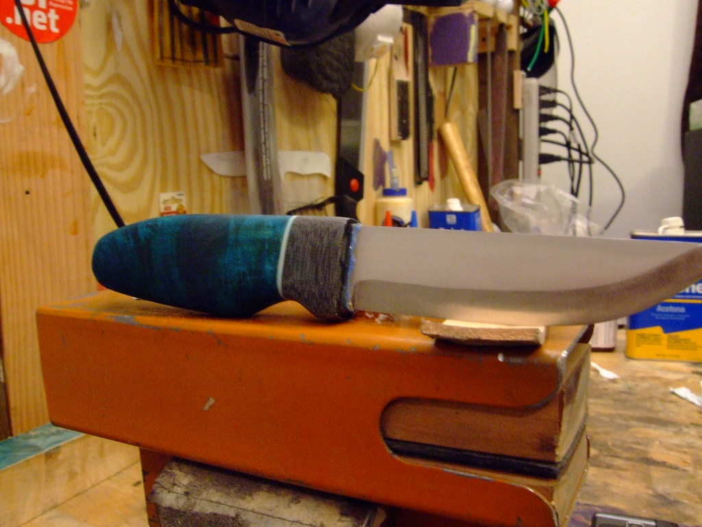

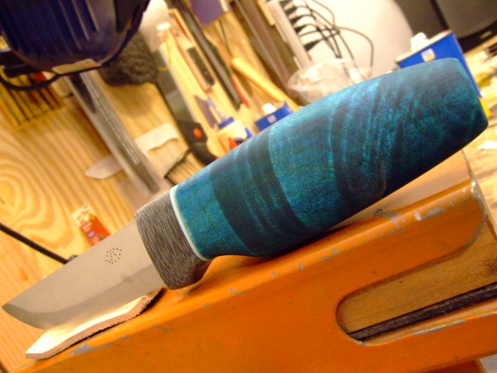

Then I sanded up to 320 grit and stained it. I am not going to say what stain I used. Can somebody can guess?

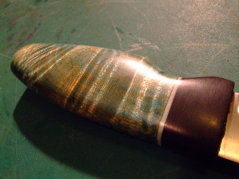

There is a somewhat linear void going top to bottom on the left side up the handle. It could be a crack, but I keep stress testing it, with an amount of leverage that could reasonably be encountered in the real world. It is holding up, so that's good. Next I wait a while for the stain solvent to completely evaporate, then I start in with the finish. I think I will apply 8 - 12 coats of a very thinned Tru Oil. That's the only clear finish product I am familiar with.
I am finding stick tangs to be more challenging than full tangs; the challenge is keeping everything lined up as I shape the handle.
Scandi grinds to me are an excellent grind. They are a challange the first few times but you stayed with it. Thats a good thing. I have made a few stick tang scandi grinds lately. They are fun to make. Is your void between the spacer and wood ? Or where the blade meets the bolster ? I would still try and use clamps on the next one to snug up the void if that is where it is.
Marko, thanks for the tip. I have seen special clamps for making these types of knives, but I never pulled the trigger to get one. On this knife, I am pretty pleased with the joints between the spacers and/or wood.
The void looks more like a crack, the more I look at it. However, I don't think it goes very deep. I stress tested the handle again by putting the blade into a vise, then pushing the handle repeatedly side to side. Unless this knife is used as a pry bar, it will be OK.
That looks pretty damn good!!! You stained the handle with a sharpie?!?!? Very nice :)
Thanks, Mike. I stumbled on another thread where a guy had stained a handle with Sharpie. So I did some experimenting.
I tested Red Sharpie on a piece of scrap wood. It looked pretty good, but it also looked like the color of fresh blood, so maybe not the best color for a knife handle. So I went with the light blue.

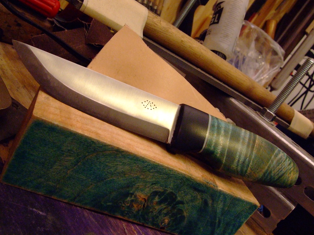

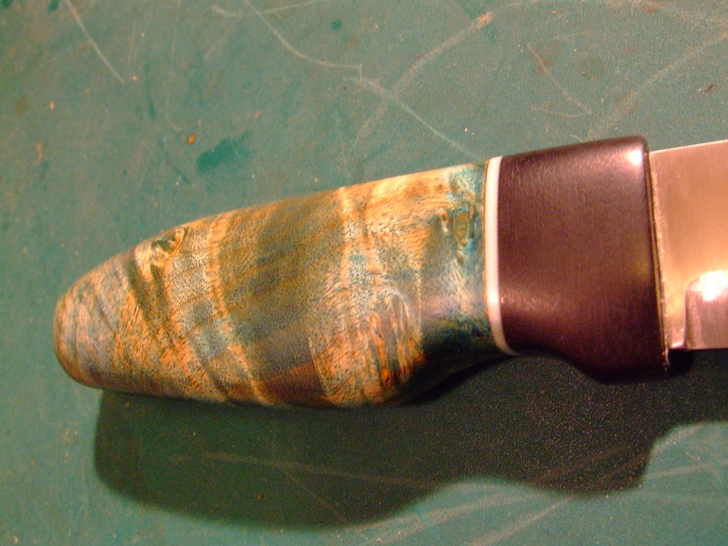

Now I have five coats of Tru Oil rubbed into the handle. I just can't seem to get rid of hazy streaks. I rubbed it first with a red scotchbrite, then a dark grey scotchbrite, but still the hazy streaks, if I look close. I don't have any of the micromesh, or I would use that. I think I'll try 1500 grit and 2000 grit sandpaper.
I need to make the bevels look nicer, and clean up the area where ricasso meets guard.

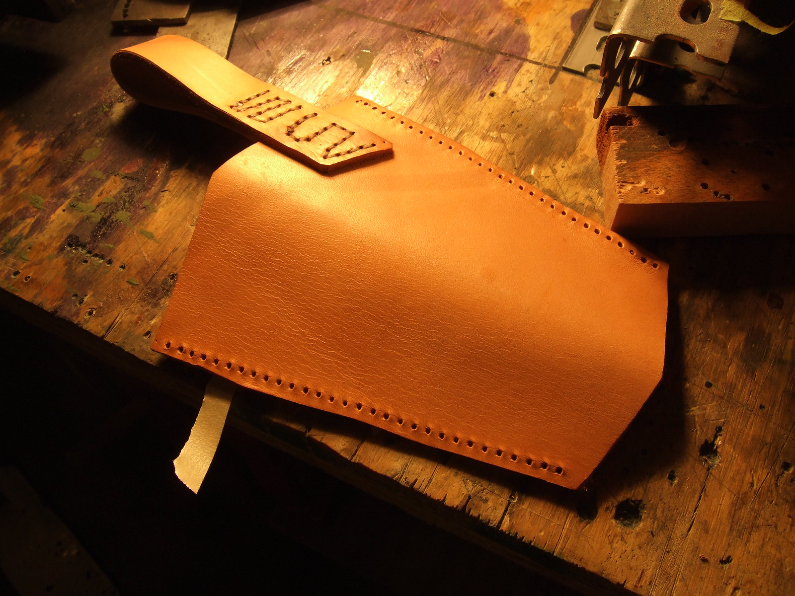

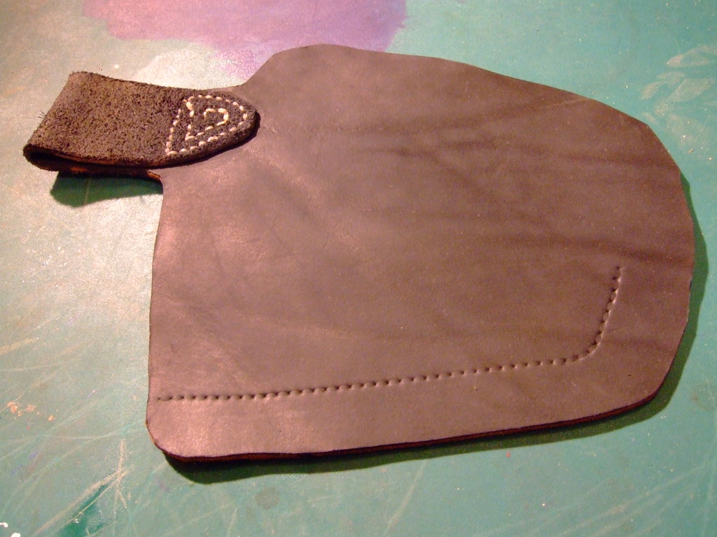

I am getting tired of this project. I tried to make a leather sheath, but it came out so ugly I don't even want to post pictures of it. I haven't decided what to do about that hairline crack on the left side of the handle.
I might keep the knife and do some field testing with it, I might give it to someone, I might sell it, but I think the hairline crack would diminish the value a lot.
For now, it hangs in my kitchen.
Thanks everybody for your questions and feedback.

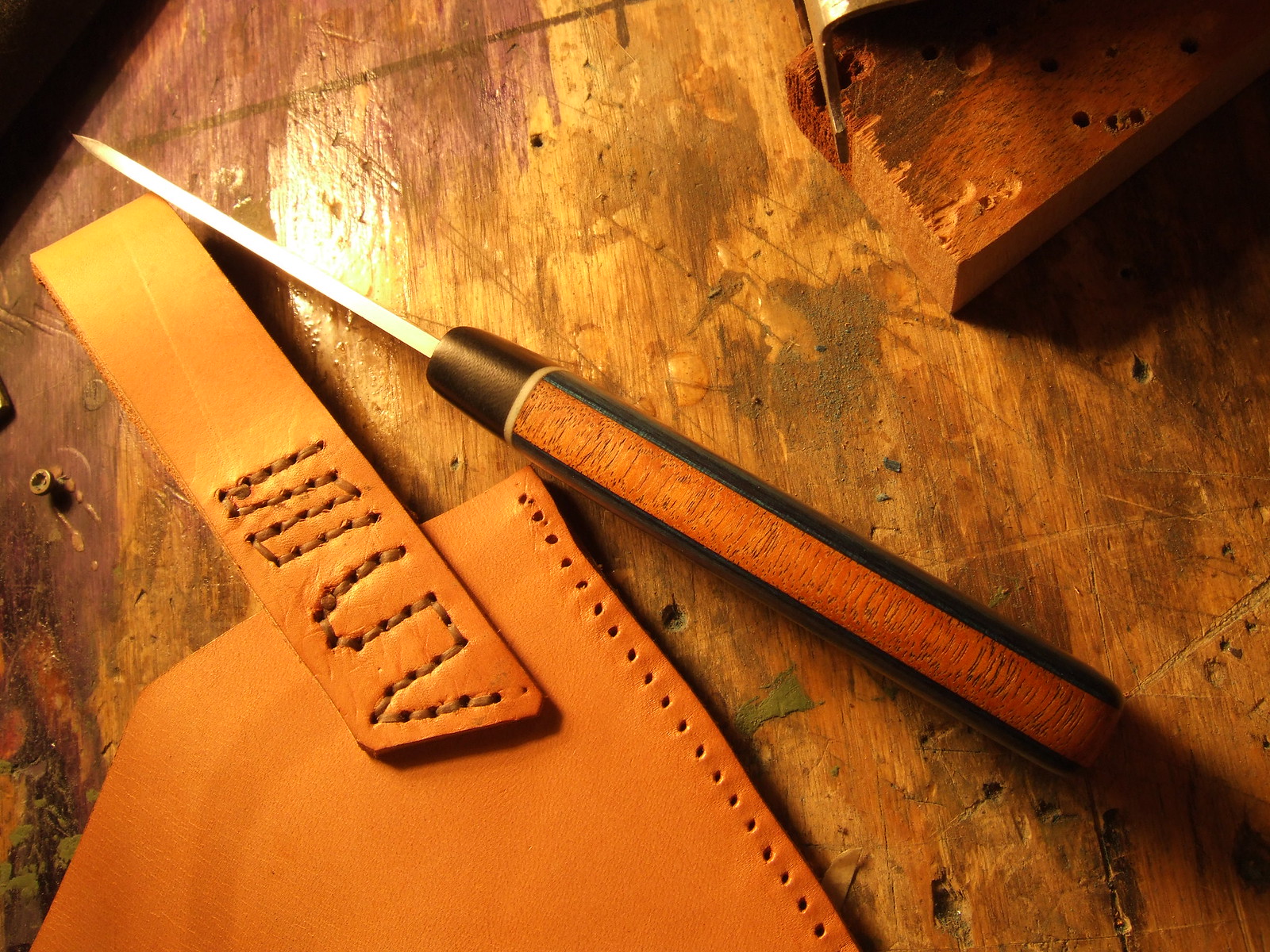

Progress:

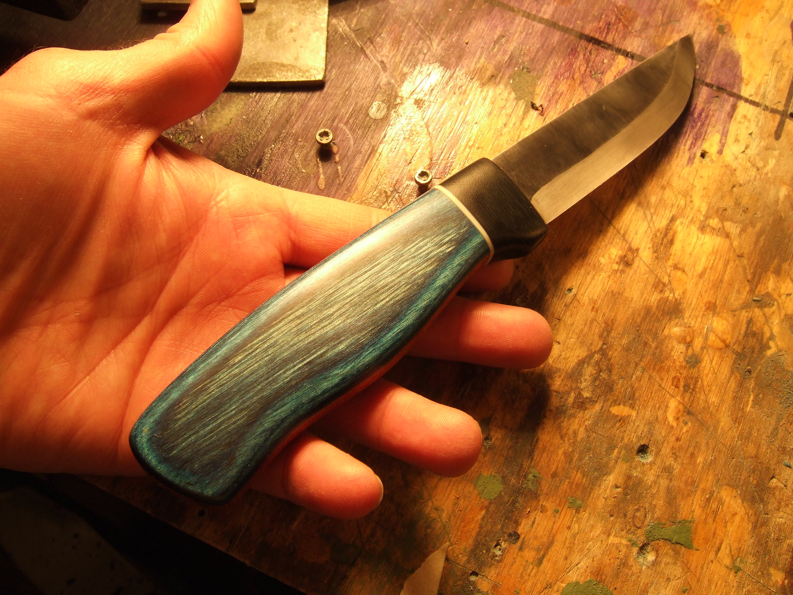

I didn't want to keep that handle on there, since it had that crack in it. So I tore it off. As I was cutting and tearing off chunks of it, I could see that the crack went about 3-4 mm into the wood.
I scrounged around and found some handle materials: Stabilized mesquite and dymondwood. I kept the original micarta guard and g10 spacer. I am getting started on a new sheath.
I might do some more contouring on the handle. Also, a lanyard hole would make it more visually interesting, even though I am not a big fan of lanyards.
