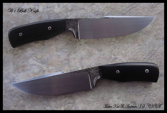

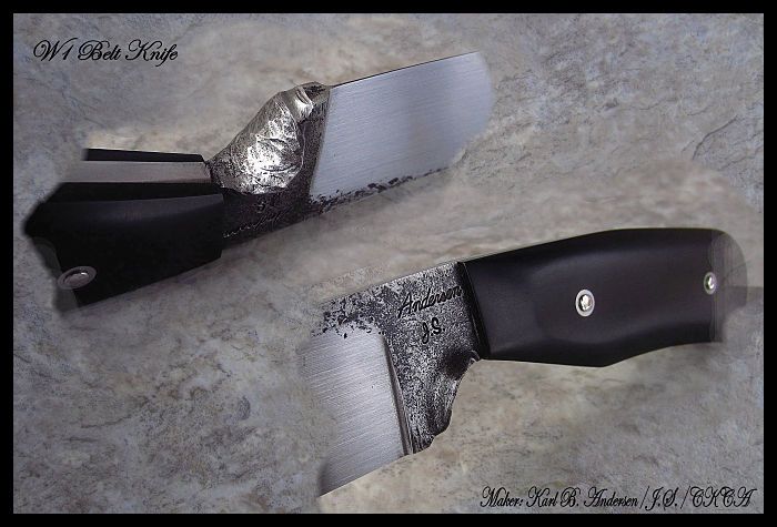

A variation on a theme.
Forged from W1 round stock.
Paper Micarta handle from some scales I bought when I first started stock removal knives in '96. If this isn't from '96, then it's from '97.
I milled and tapered the tang for the scales, which I put on with my bulls-eye pins to eliminate any stress upon the handle material from peening the stainless pins.
A little harpoon clip for cool factor.
