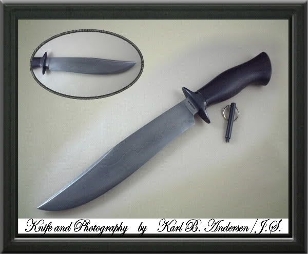

One for the Fox River Knife Rendezvous this weekend:
A "short" 10 inch W1 clipped blade that was clay processed during heat treating. The blade was forged from a 1 1/8" round bar of W1.
Take-down design includes African Blackwood full grip handle and hot-blued mild steel fittings.
It's a handful at 15 1/2".
Hope you enjoy my efforts.
Karl, Looking good! Thats got to be the largest knife I've seen of yours. I wish this Fox River Knife Rendezvous was a little closer to God's county. Sounds like a good time.
Karl,
Really appealing all around, handle and blade shape and flow, hamon and guard. A winner,
John
Karl, that is definitely the finest blade I've seen from you (and that is saying a lot!)
That is really stunning, just wow...
Great looking bowie! That handle and guard makes a comfy looking grip. I'd like to see a shot showing that hamon with more contrast, though! :)

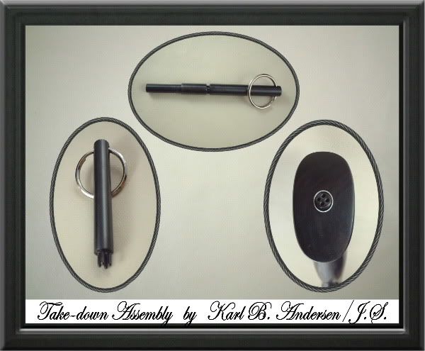

I got asked for a detailed photo of the assembly pieces, so here ya' go!
Screw and wrench are hot blued mild steel, and the pins are hot blued and hardened O1 dowel pins.
That's wicked, Karl!:thumbup:My favorite from you, (that I've seen) so far.
I dig the darkness.
I agree with Lorien and Jonathan, this is definitely my favorite of yours so far. :thumbup:
I do have one suggestion for you though; make your pictures bigger! :D
My personal preference would be for the guard to not be blued, but that doesn't take away from the fact that I like this knife a lot.
Outstanding piece Karl. I don't care for ABwood but it suits this design so well.
From handling your knives I know that execution is top notch on this piece.
You keep raising the bar.
