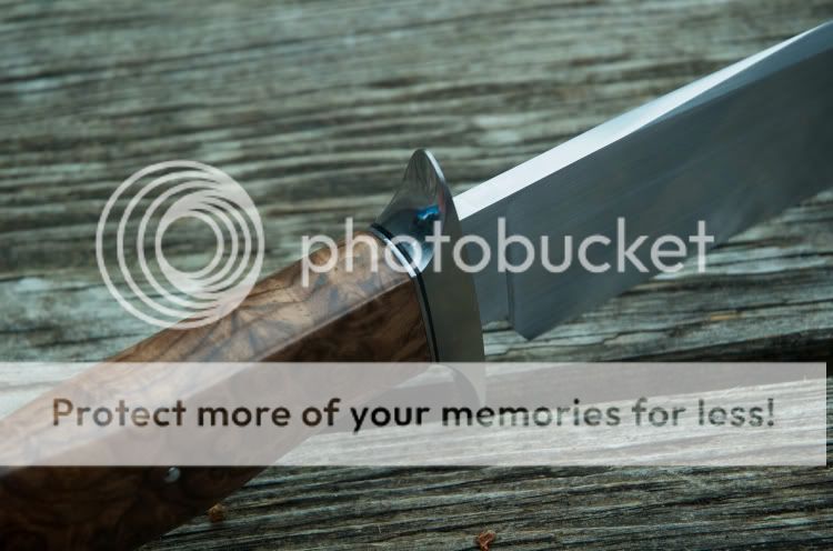

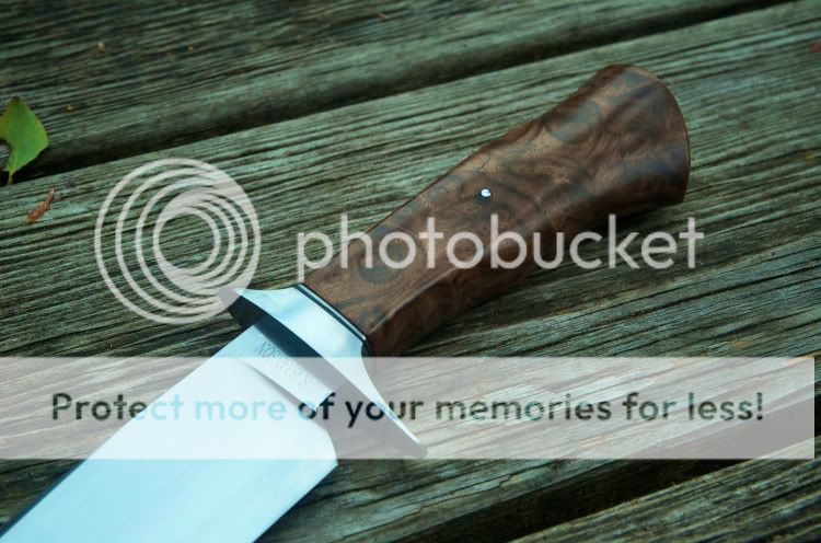

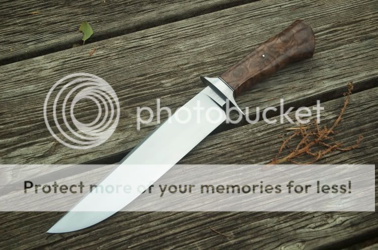

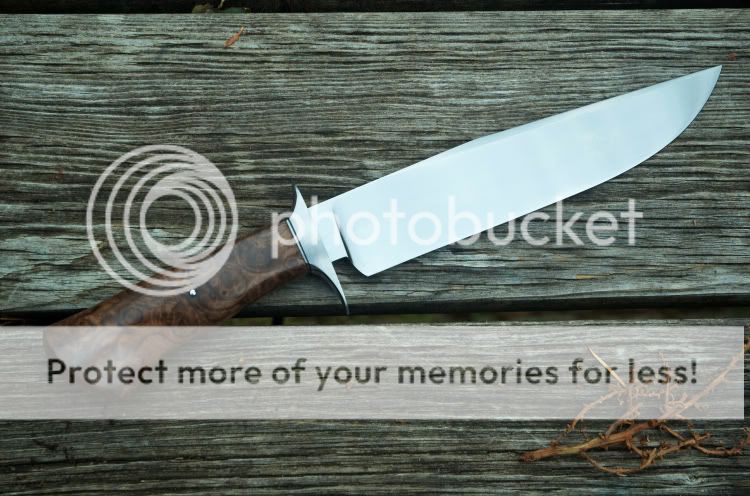

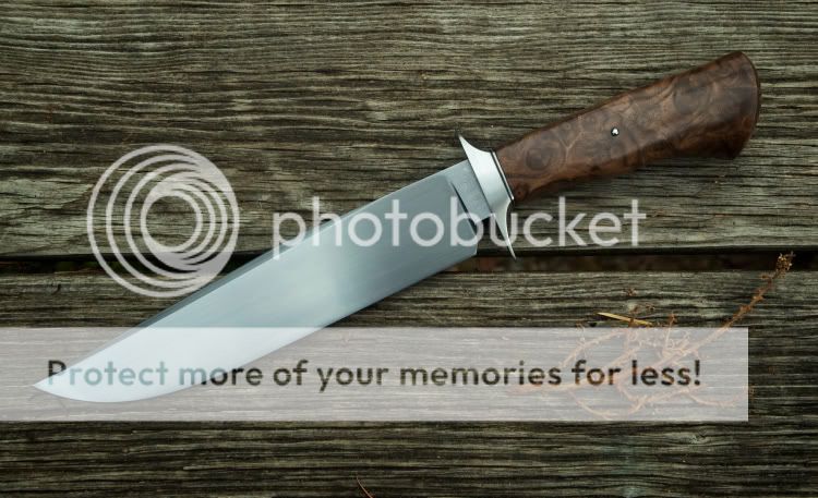

Just finished this yesterday.
I'm working on doing so satin finished blades and I am really enjoying the look. There is a hamon but it's very subdued.
The blade is about 8 3/8" W2
OAL is 13 5/16"
416SS guard and domed pin.
I counterweighted the butt so the balance is just in front of the guard.
Any comments or criticism are appreciated.
Thanks for looking.

this knife reminds me of many other knives of this genre. It's unmistakably Branson however. Something about the lines makes it unique. Kinda reminds me of your whaling knife, even though it's very different obviously.
The squarish edges on the handle as it approaches the guard are something I had to get over, they bugged me a bit at first. But on a knife like this, those flat surfaces and subtly abrupt edges probably give a lot of leverage from spine to edge, and lots of control over the angle of approach in the swing, plus the ability to maintain that angle upon contact/impact.
I like the domed pin a lot. It contrasts very nicely with the polished backs of the guard, the smoothly finished, highly figured wood and the satin finish of the steel. The black and stainless spacers do wonders and without them, I think this knife would suffer for it.
The guard is very graceful.
The plunge leaves the ricasso in a very interesting spot, and is so nice and clean.
Aesthetically, I think it's a winner.
From a design perspective, I'd like to see this exact same knife, but with a little less belly, and the blade slightly less wide. Maybe 1/2" shorter too. It looks to me like it wants to be more of an 'insert and twist' type of weapon, than it looks like a camp tool/bowie.

Thanks for your thorough assessment. I have to agree with the comments about the belly making this look more Bowie than Fighter. In the hand, the sense is different and the balance pulled back a little removes it from the "camp knife" category, I think.
The "sharp" edges on the handle are not sharp except as a feature. They are nicely rounded more on the underside than the spine. That area of the spine however sits right in the web between the thumb and index finger and so those angles never really even come into play in terms of the grip, unless gripped like a baseball bat.
As far as your design change comments... well that's another knife. It's easier for me to call this a bowie than change all that. :p
I'll have to double check the thickness but if I remember correctly, it's a tad under a 1/4" and tapers towards the tip.
