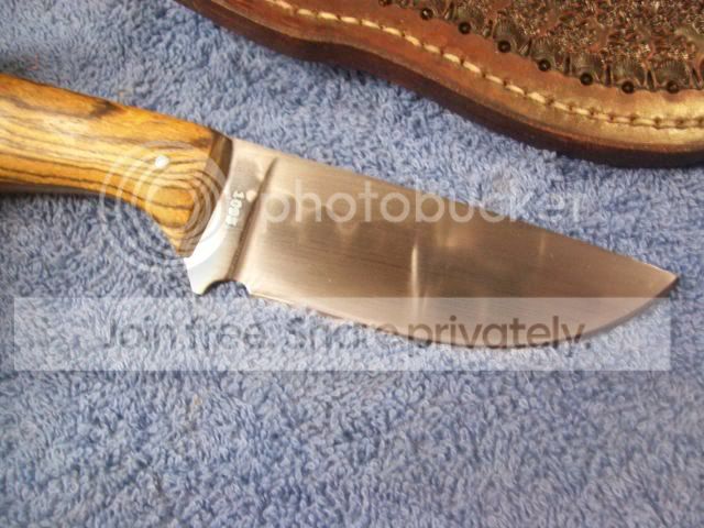

You should be able to see your hamon activity straight out of the quench with a 110 grit belt clean up..Aldos original certs for his W2 Mn were 0.215, I think,Dons were about 0.22..Pretty mucn the same..His 1095 is about 0.40..
Less clay, lower temp and a good 8 minute soak has always worked for me..We just did a 1095 hunter with Aldos 1095 and it made a nice hamon..
heres a W2 blade of Alsos stuff where the furnace cement was just dabbed on..The hamon follows the cement precisley..This is only a 600 grit polish with flitz..Just a working polish..
Then heres one with his 1095, again just a 600 grit working polish with flitz..
I have been using both Aldo's W2 and some of Don's. I didnt notice much of a difference with the hamon between the two, but sometimes I hit it and sometimes I dont. For me it usually has more to do with being able to keep it hovering at right around 1460 or 1475, but not much more. If I go over 1500, it seems like the hamon doesn't pop as much.
The times I have used W-2 if the hamon is there you will see it even when your grinding with a 50 grit belt. I had bought some of the 5/8 W-2 in the round bar a couple years ago from Aldo and wasn't having good luck with it since I wasn't wanting to do a water quench. I traded it for some of his 1095. Problem solved.
Lower temps seems to be a key..I usually go for 1440*-1450* on W2 and 1086M...That W2 I posted above follwoed the clay to well..Now i make sure to "draw" the draw on instead of being so haphazard..Not that my hamons are anything special. I think they could be if I would take the time to be a real polish...
On mine,( Aldo's W2) i soak 10 minutes at 1450 and straight into #50. Have had pretty great luck with it so far. I do run the clay pretty thin 1/16th i think.
