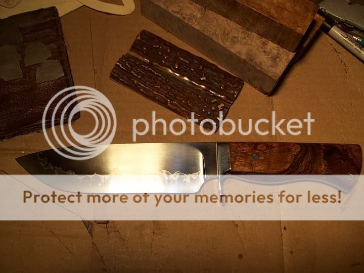

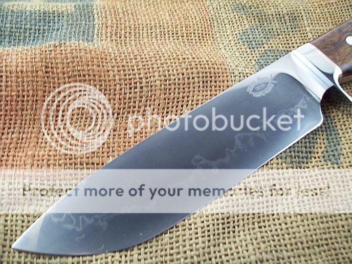

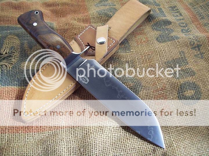

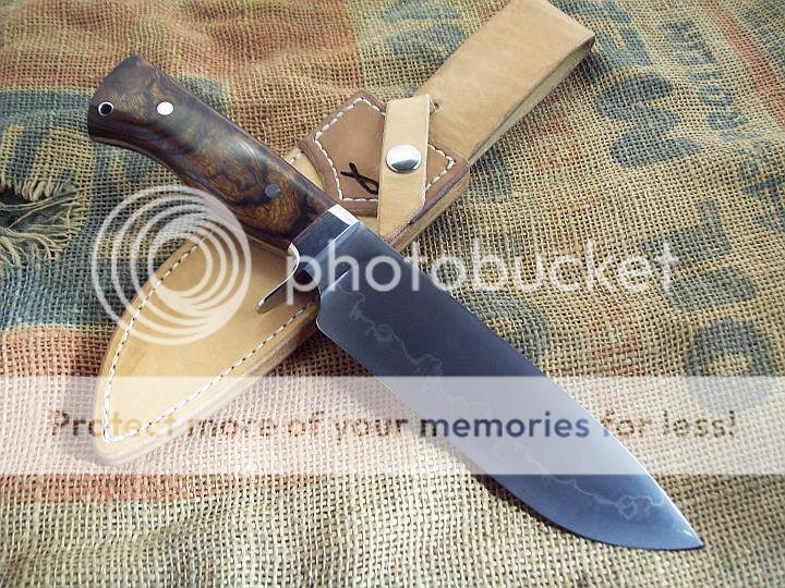

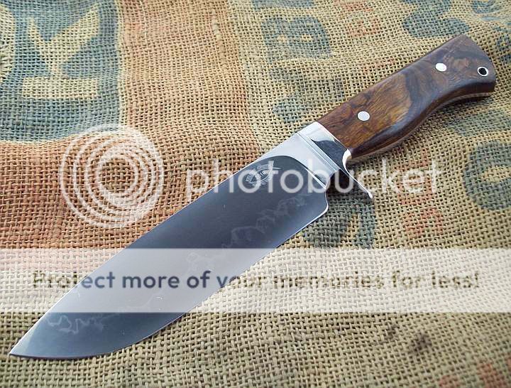

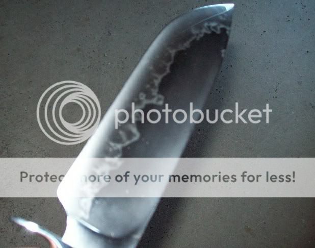

After extensive note taking and experimenting, I'm starting to get comfortable with my technique and understanding in creating and etching Hamon.
Shown below is one of my GUS Camp Knives I just finished.
For those who may not be familier with this knife, GUS features a full (tapered) tang vs. my Traditional Camp Knife, which is built on a nearly full handle length stick tang.
Blade length on the GUS is 7-1/8" L. with an OAL of 12-1/4"

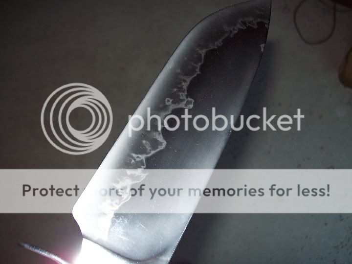

This GUS is forged W2 and shows a beautifully active Hamon.
Handle scales are Desert Ironwood backed up with a thin bright red liner.
I added a short spacer stack (655 silicon bronze/416 stainless/red liner material) between the pinned & soldered 416 stainless guard and the Ironwood scales.

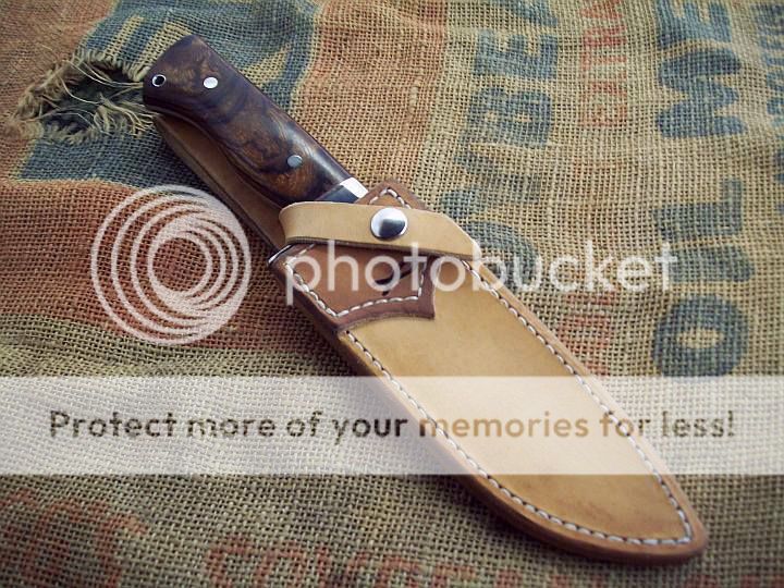

Sheath is hand sewn 9-10 oz. veg tanned leather with a neatsfoot oil finish.
Despite my best attempts in my photo studio, the photos that show the Hamon activity best are the ones I took in the shop, knife in hand :o
I hope you guys like what you see :)
Thanks a million for looking :thumbup:

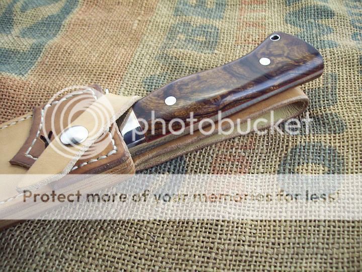

And a couple pics with her pants on ;)
Again, thanks so much for checking out my work :thumbup: :thumbup:

Very nicely done , I have always admired the clean and simple look of your work.
Leather work is top notch as well.
That looks like a great knife, David. I think the sheath compliments it very nicely as well. Great job! :thumbup:
David...
I would say everything you've done to date to accomplish such a wonderful hamon has not been lost..this turned out fantastic....
it is a great looking knife. Especially your blade finishing.
The finger guard looks a little long to me for its thickness but overall this is a pretty nice design:thumbup:
Oh man, what a honey of a knife. The killer hamon will grab all the headlines here (and why not, I mean LOOK at it!) but what does it for me is the elegant combination of the curved plunge and stout spearpoint profile.
Silicon bronze accents go great with ironwood - and a great many other woods, for that matter.
Roger
Fantastic David!!! A darn near perfect all-around user there. Probably my favorite style overall blade ever.
What's not to like she's a beaut! Very well done. I'm sorry how thick is Gus?
Thank you very much guys.
With the exception of my family, nothing I've done in this life has so captured my being like knifemaking has.
I hate to be redundant but, I love this stuff !! :thumbup: :thumbup:
Thanks again :)
:cool:
I have to agree with Roger. The hamon is sizzling, but the grinds and finish on the blade are eye-popping. Just beautiful.
