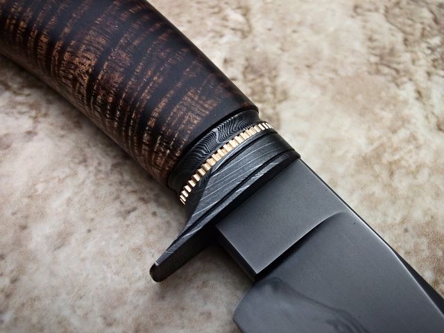

Here's a hunter I finished recently. Seems appropriate for this time of year. This is nice and thin, even at the spine and is ground thin to match. It's a really keen edged slicer. Hard to go wrong with w2 and koa.
Specs:
Hand forged from W2 steel
No Clay, auto hamon with time and temp control of my salts.
8 3/4" overall, 4" blade, .160" thick at the ricasso
Full distal taper ending in a fine piercing point, false edge, not sharp (of course
Heavily rounded spine and ricasso edge
My own damascus fittings, double line cut guard and fullered spacer
Coined bronze accent
Stabilized Koa hanlde
Damascus bolt cover
All comments and discussion welcome.
