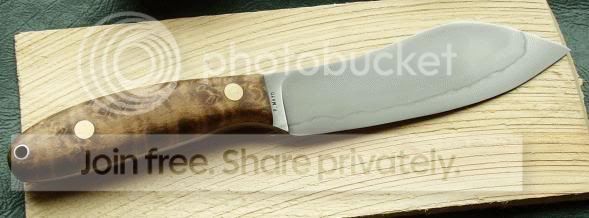

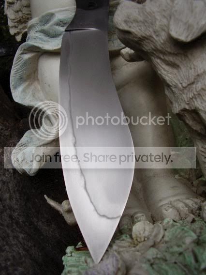

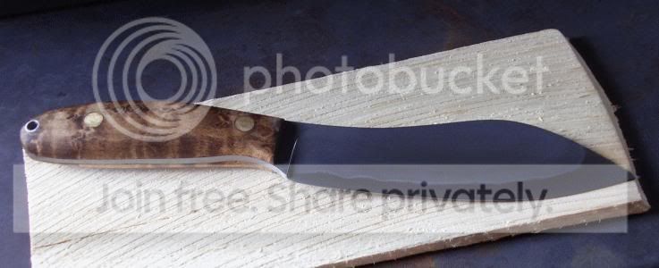

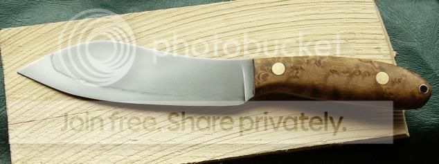

I just completed this nessmuk, hand forged from W2 flat ground. with a slight tapered tang.Blade -W2 clay hardened in oil
Handle scales book matched birds eye maple with walnut danish oil.
Loveless style brass pins and a s.s. thong tube.
O.A.L.- 10 1/4" with a 4 7/8" blade 3/16" thick at the top of the hump.
Thanks for looking all comments welcome.
Bob

There is an intrinsic beauty to a design that is simple and functional. When you add pleasing curves, a nice hamon, and an elegant wood grain it becomes a classic. A very nice job.

Simple, elegant, with a nice flow of the curves... And the clay temper complements it nicely, and must have produced a very sharp and tough blade...
Apart from the clay hardening, did you temper the blade and, if yes, how?

Yes the blade was tempered twice at 475 for an hour each time.
