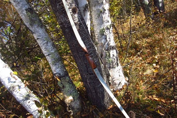

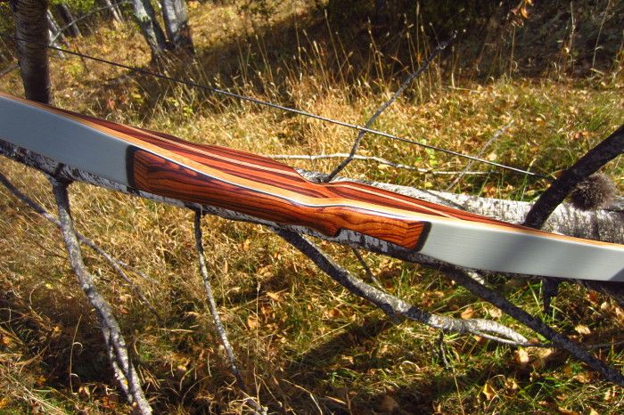

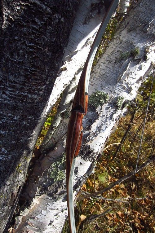

Sweet little hunter, Karl:thumbup:. Has your archery season started out there yet? Mine has come and gone:grumpy:.
