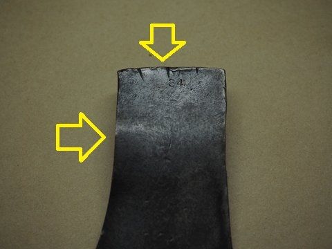

I've got a w34 axe head, but I'm not sure if it's worth re-hanging. Are they decent heads? My main concern is that the 'hole' for the handle seems to taper towards the top. Wouldn't this make it loosen up easier?

Uh, when you put it on a handle make sure the widest section of the hole is at the top where it is supposed to be?
It's possible I have it wrong, but I'm considering the top to be the side that shows some peening in the pictures. It's also the side that is straighter - the 'beard' of the axe hangs down more in the other side
It looks like it has a lot of tempered bit left to work with. You could sharpen it and simply follow the existing grind. There is more wear on the toe than heel - you could reprofile it and it would look good/function well.
Without a picture of the poll face I am assuming the poll damage looks like cuts and mushrooming as opposed to "spalling or cracking" from poor construction. It was used as a hammer. Looks like that use maybe deformed the eye a little and that is why you are questioning the eye size bottom to top? If it is more deformed than what I see in the picture or you know you or someone you know will be leery to use it then I personally wouldn't. It does look as if the hammering was focused on the bottom of the poll and deformed the base of the eye.
If you have calipers you could make sure. Having it in hand would make a difference in figuring it out.

I measured the eye. The top (i.e. flatter side with more peening) measures 0.71" x 1.96". The bottom, with the beard, measures 0.825" x 2.19" Yes, I could flip it, but wouldn't it be wrong to have the beard on the top edge?

It looks like the bottom of the eye is larger than the top. That is due to striking damage. Unless you want to push the eye back in you aren't going to have the intended flare or widening at the top. It's designed to be wider at the top so the wedge will spread the tongue to either side to lock it on there.
That head is not designed to be hung upside down. You are correct in you definitely should put the "beard" down if you do hang it.
Maybe someone can recommend a fix for it. Depending on your skill level it could be worth it. It's got character.
Someone might say just run it as is but even if you get it secured it might prove to be a bear to hang straight on the handle.
I could be all wrong as well and it might just be a matter of dropping it lower on the handle to account for the space left from the eye being pushed out and a creative/careful wedge job.
It seems strange to have the bottom larger in both dimensions. It does appear that the bottom was squeezed lengthwise in the photo.
Stupid question, is there a lip on the top side of the eye from being peened over that could be causing the top of the eye to seem smaller? In that case I would recommend filling down the lip prior to hafting.
There is a small lip from the peening, but I doubt it will amount to .25" on the length or .1" on the width.
I almost wonder if it was a factory mistake, and the users kept beating on the top of the head to re-seat it. Ergo all of the peening.

But what he's got is an axe with a mis-formed eye - larger at the bottom than the top. That's an issue but not a show stopper. The key is if the center of the eye is smaller than the top. As long as this is true the axe can be hung securely. If the wedged top is larger than the center then the axe head won't come loose. Just hang it and wedge it like we all do - leave the haft protruding 1/4" through the eye and wedge it. The wedged/widened protruding haft will stay put. It wouldn't hurt to soak the top of the haft and the eye with Swel-lock (or generically DPG) when you're done.
I've got it hafted and wedged. Looks fairly secure, but the proof will be when I get a chance to use it.
I still need to cut it down. Leaving a 1/4" of the haft protruding would be the best route?
You should cut the haft 1/4" above the eye before wedging.
But at this point you might just cut off either side at 1/4" and then see if you can drive the wedge any further. It may be tight now.
