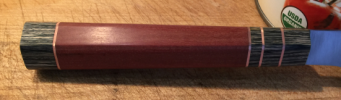

You guys rule seriously. This may not look great to anyone else but it’s a big improvement for me in terms of straightness. Handle jig was HUGE thank you what a great idea. I filled the 1/2 hole with 5 minute epoxy and basically held it straight till I thickened up. Then I took it out and put on handle jig paying more attention to squareness relative to the slot for the tang. The blue tape thing works great.
Glad you're making progress. I can't take credit for the jig idea, Natlek first posted about it.
I am glad that worked for you :) did you mean to attach a picture of your creation??
