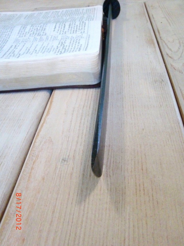

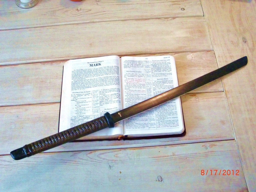

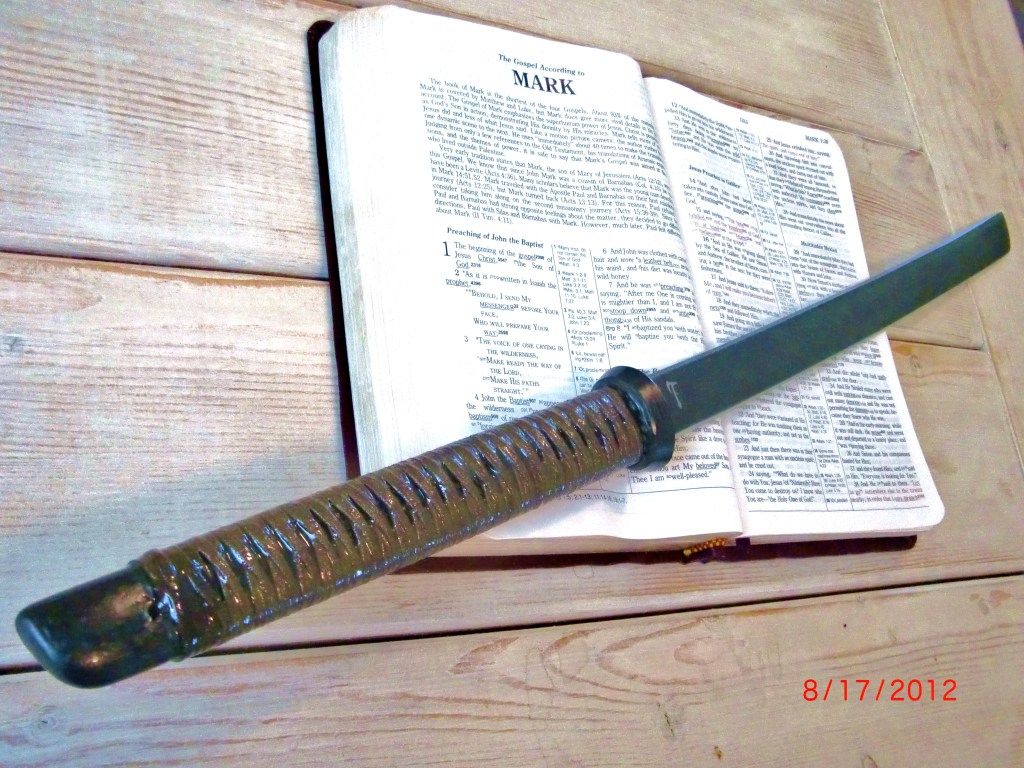

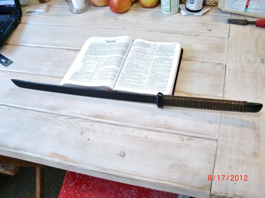

This is my first sword
its short and stout like me, and I really want to keep it... so dont buy this! please!
My first attempt at making a waki ended in me breaking it in half after trying to straighten it after HT 4 years ago! been too angry to try again.
This is not a super traditional waki, more modern with some old school for looks. I made this to be used but still look good. I hope I accomplished that?
Alphahunter tactical and I will be doing a short run of a tactical Waki in the future, this was to prove I could actually make one before e started
Handle is 6 layers of carbon fiber laminated together around a slightly narrowed full tang, bolted with 3 hardened 3/16ths chainring bolts, then epoxied to the tang. Tusuba is .5" carbon fiber laminated to the handle and tang. Then wraped in hollowed out coyote brown 550 cord, then epoxied in place to keep it there for ever.

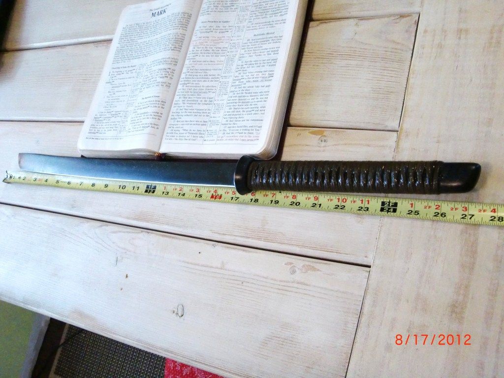

Specs:
CPM154CM .200 thick, steel is from Aldo (NJsteelbaron.com)
Blade is 17.5"
Handle is 9.25"
Acid stone wash finish
No sheath
$500
if you plan to use paypal add 3%.
PM or email me for payment info
jakehobackknives@yahoo.com
http://www.youtube.com/watch?v=9SXrVntRrw0&feature=youtu.be
Sorry for the terrible pics! hard to get a good pic of it.
