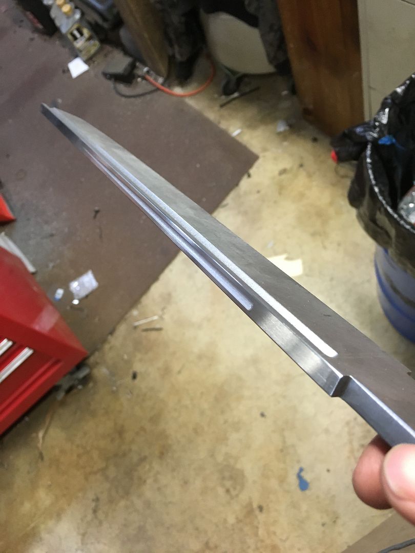

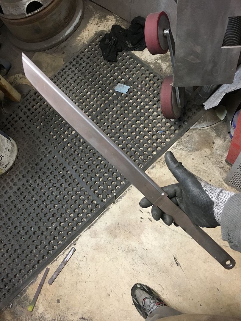

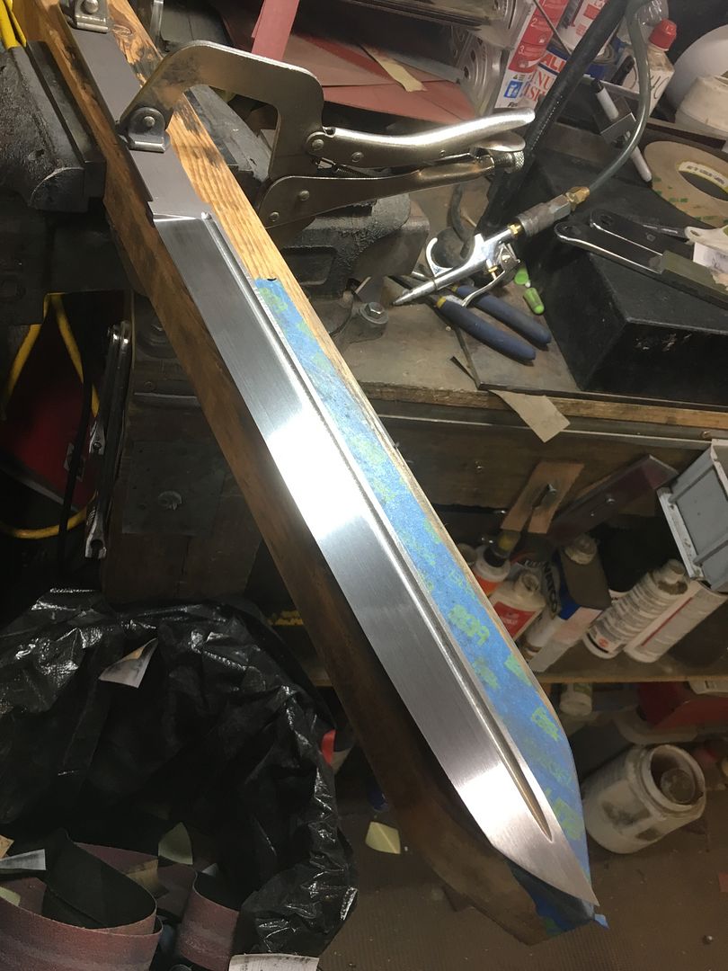

Hey guys! I am working on a new wakizashi design and I figured I would put up a few pics of the build along the way. This one is a bit different than my other waki. With it's narrower/lighter blade it is less chopper and more battle blade. Steel is .290" Cpm 3v, OAL is a about 22.5" and the blade is just over 14".
Here is a video showing me starting the fuller on one side of the blade. I take about .005" a pass for roughing and finish passes are about .002". This is all done manually. :)
[video=youtube;dNR319dxYc0]https://www.youtube.com/watch?v=dNR319dxYc0[/video]
Here is the finished fuller......

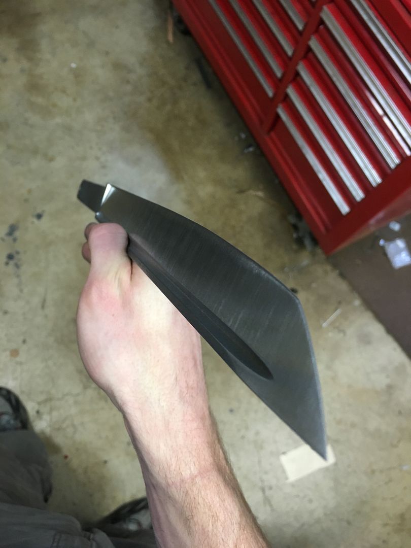

After I finish profiling the blade, I mill in my signature tapered fuller in the spine.
The finished profile, ready to grind.
Looks nice! Will it have any sori?
A bit. It has a bit of built in Koshi Sori in the handle/blade area. The rest will develop during the quench, so we will see how much after I heat treat it.

Thanks guys. Grinding it right now. More pics tonight.

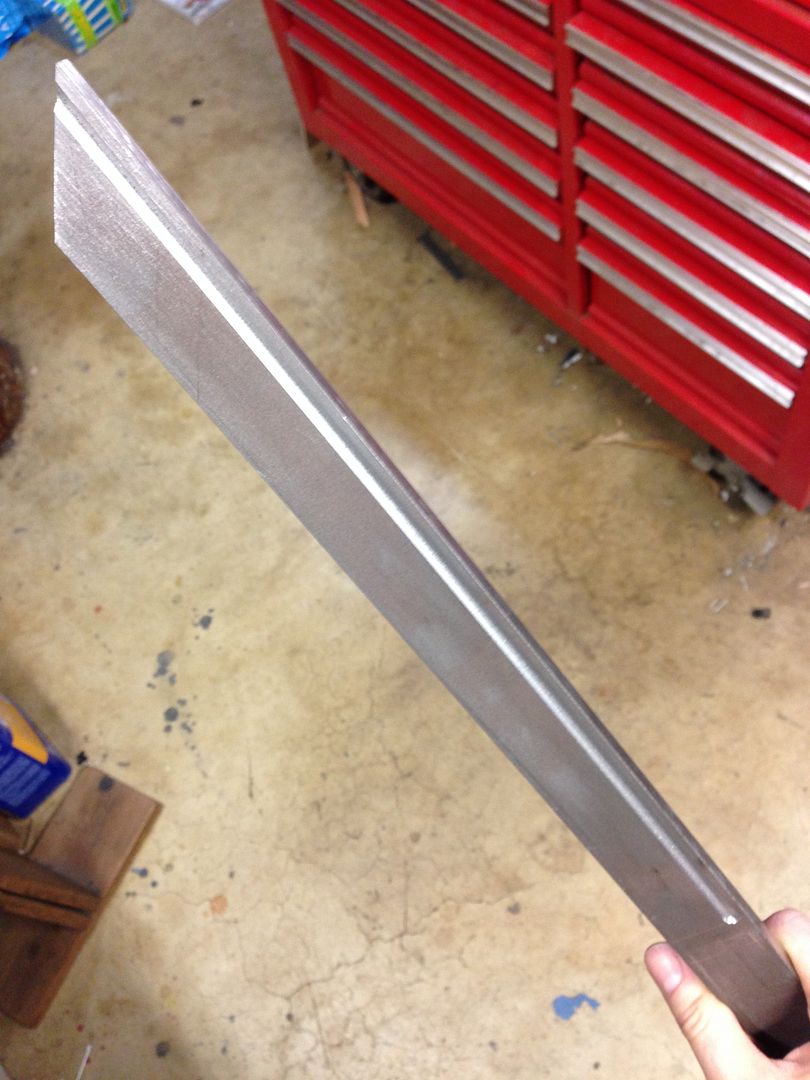

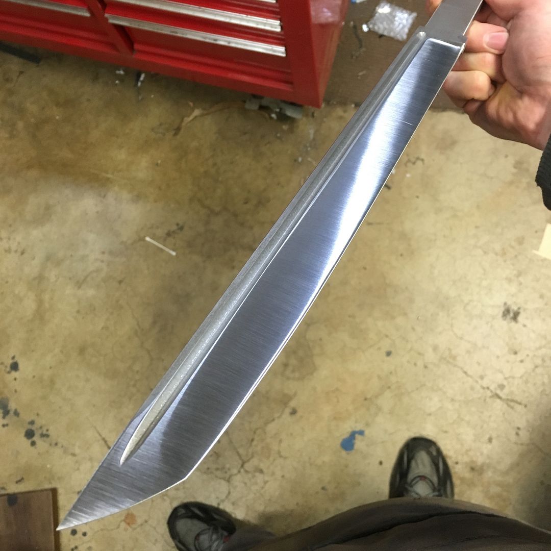

Ok guys. Sorry I didn't take more pics, but here is the blade ground.

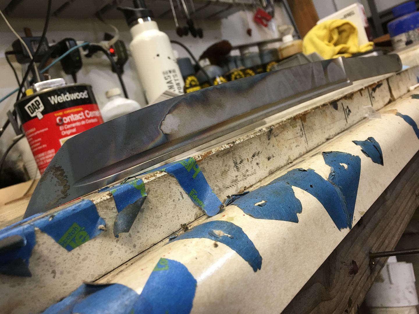

Doing the pre HT hand sanding. I like to do this on 3V saves me from finding a deep scratch after it is hardened. Which is stupid hard to sand out post HT.

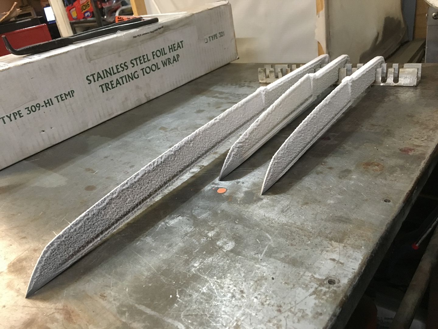

Seriously one of the best things to me is building a sword that's a tribute to ancient design, out of uber modern steel, and having it develop sori while plate quenching. Such a full circle thing for me.
This pic is post hardening and ready to go into LN.

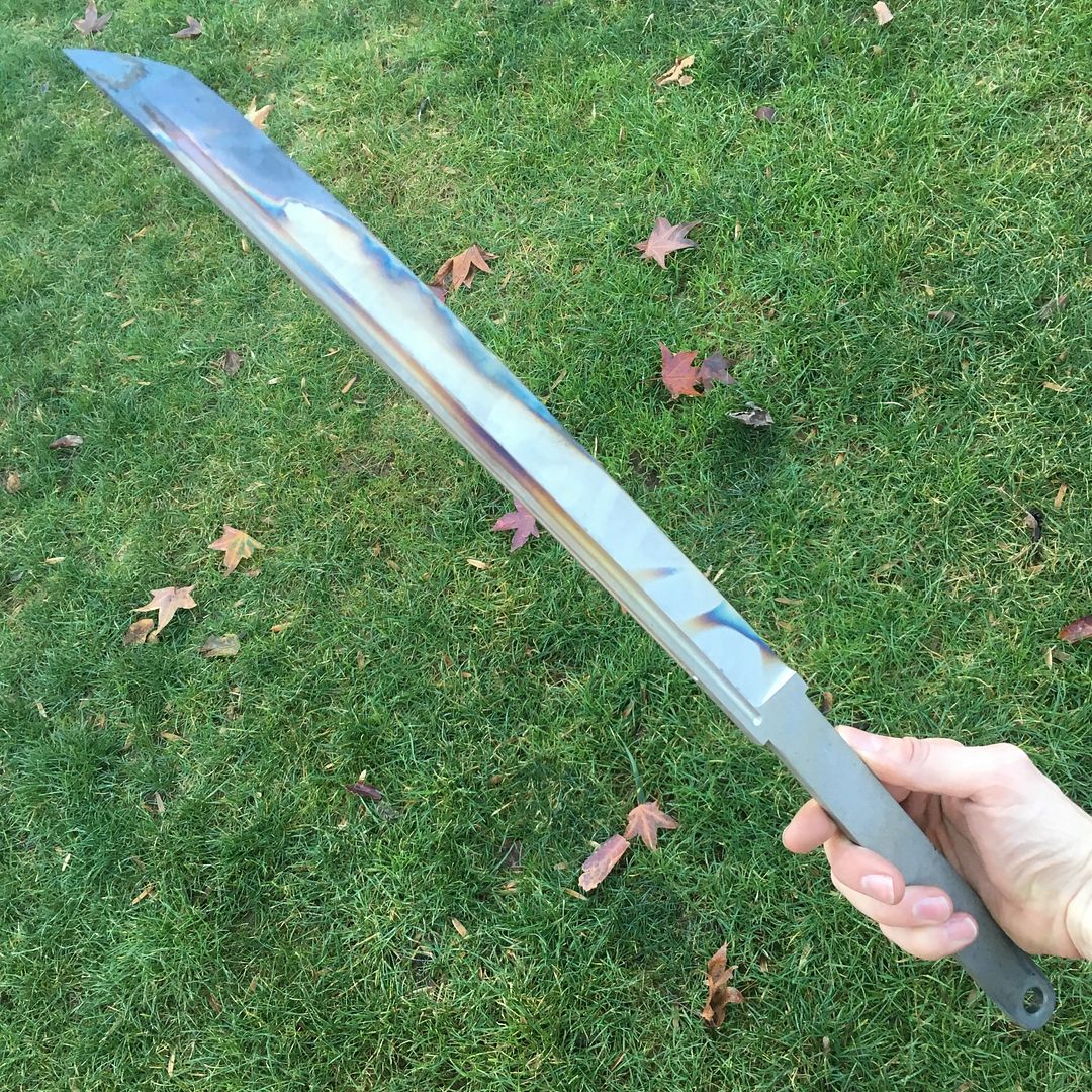

Fresh out of the Liquid nitrogen.....
Tempered and ready to finish......
