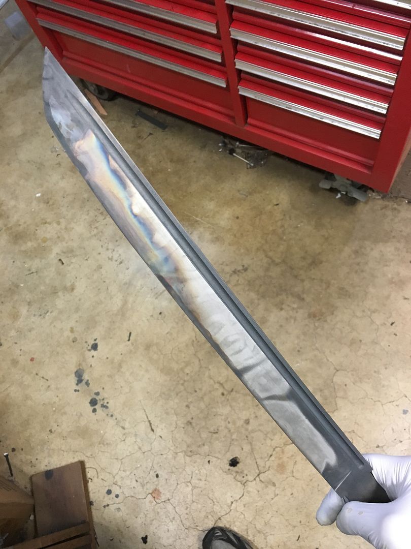

Here is the blade after I blasted and blued the fuller and flats.

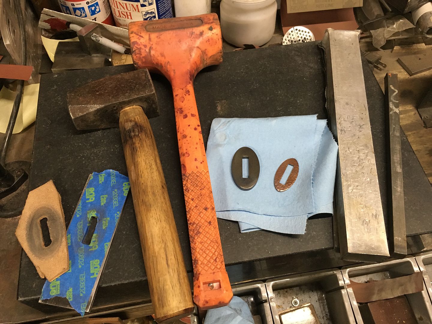

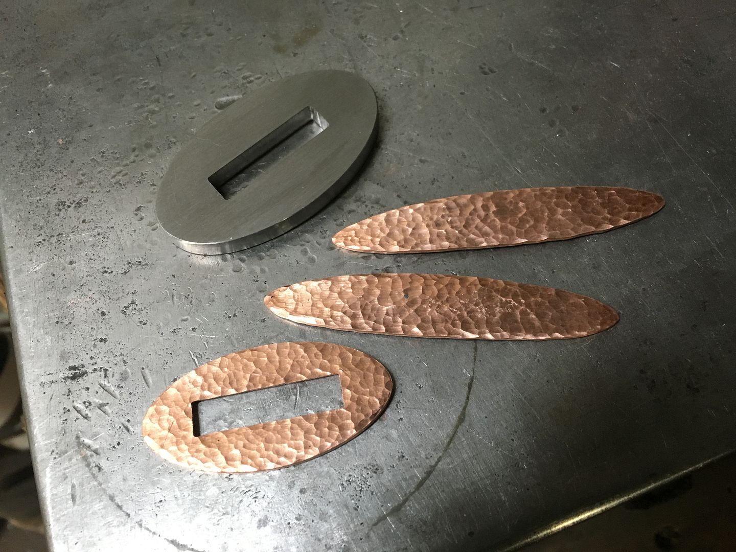

Hammered copper Menuki and seppa. Also the titanium tsuba. I give it an orange peel texture after I fit it up to the tang.
I thought I got a picture of just the finished fittings, but apparently I didn't. I'll show pics on the finished blade.

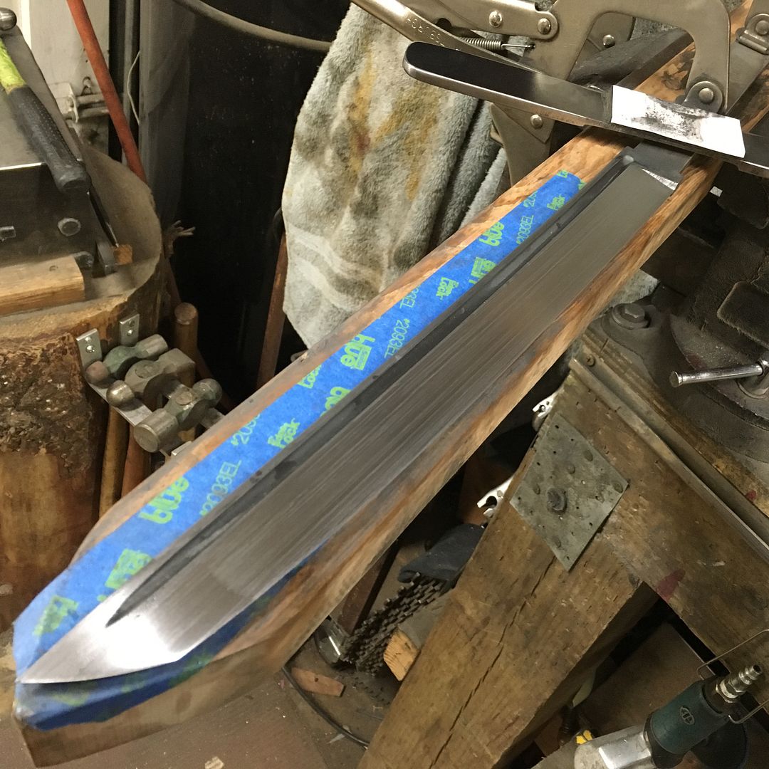

I spent all afternoon doing this! Hand sanding 14" of 3V is not fun!
And the finished blade.....

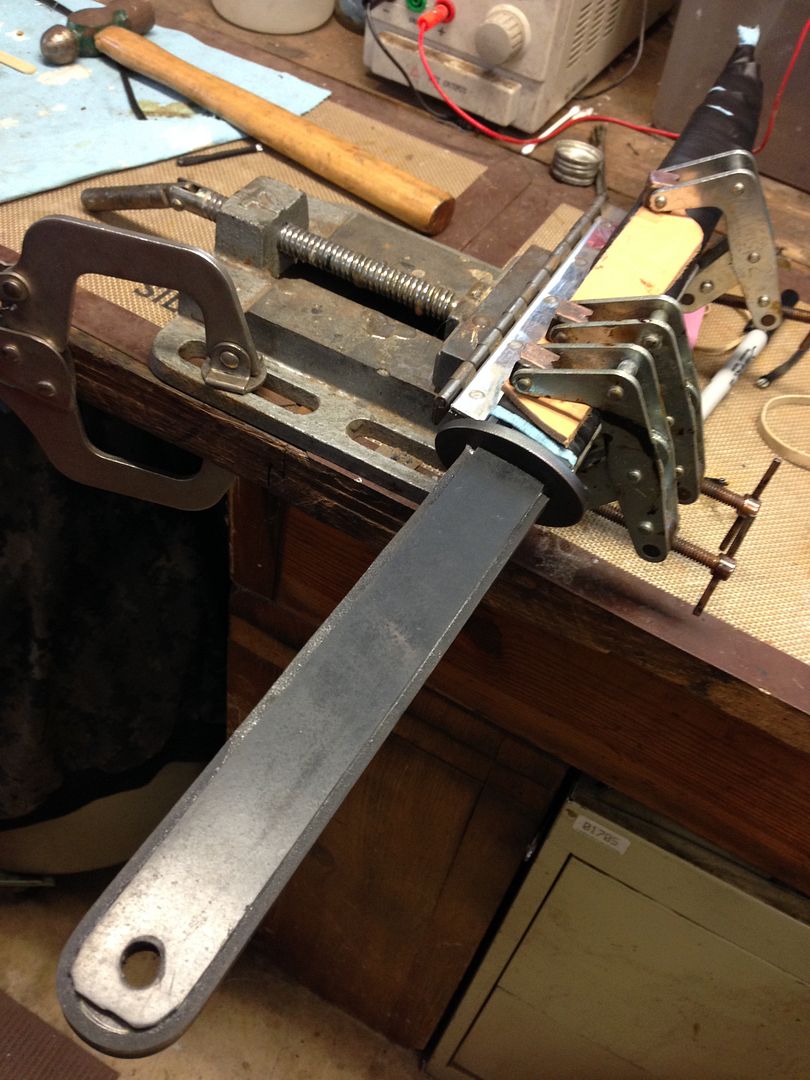

Here are the fittings and the persuaders I use to drive them in place. :cool:

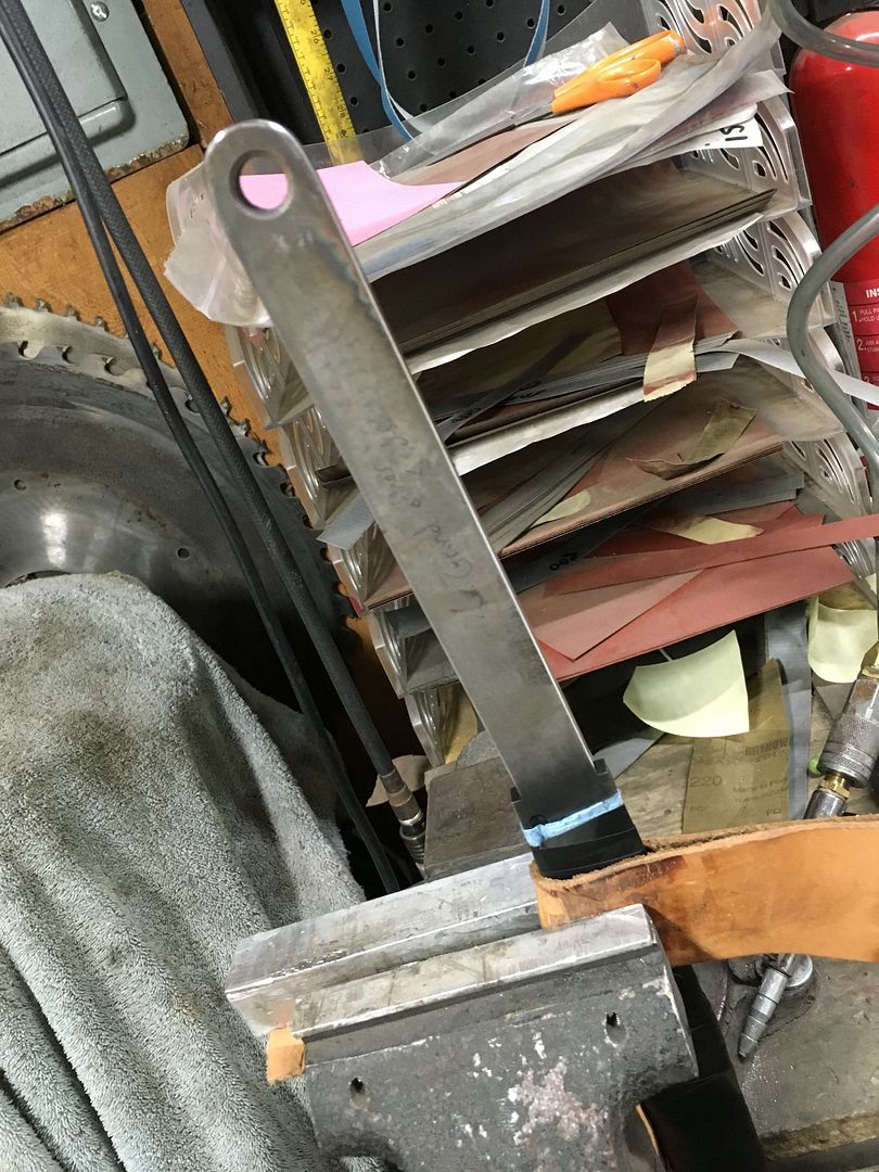

The blade clamped in my vise ready to drive on the fittings.

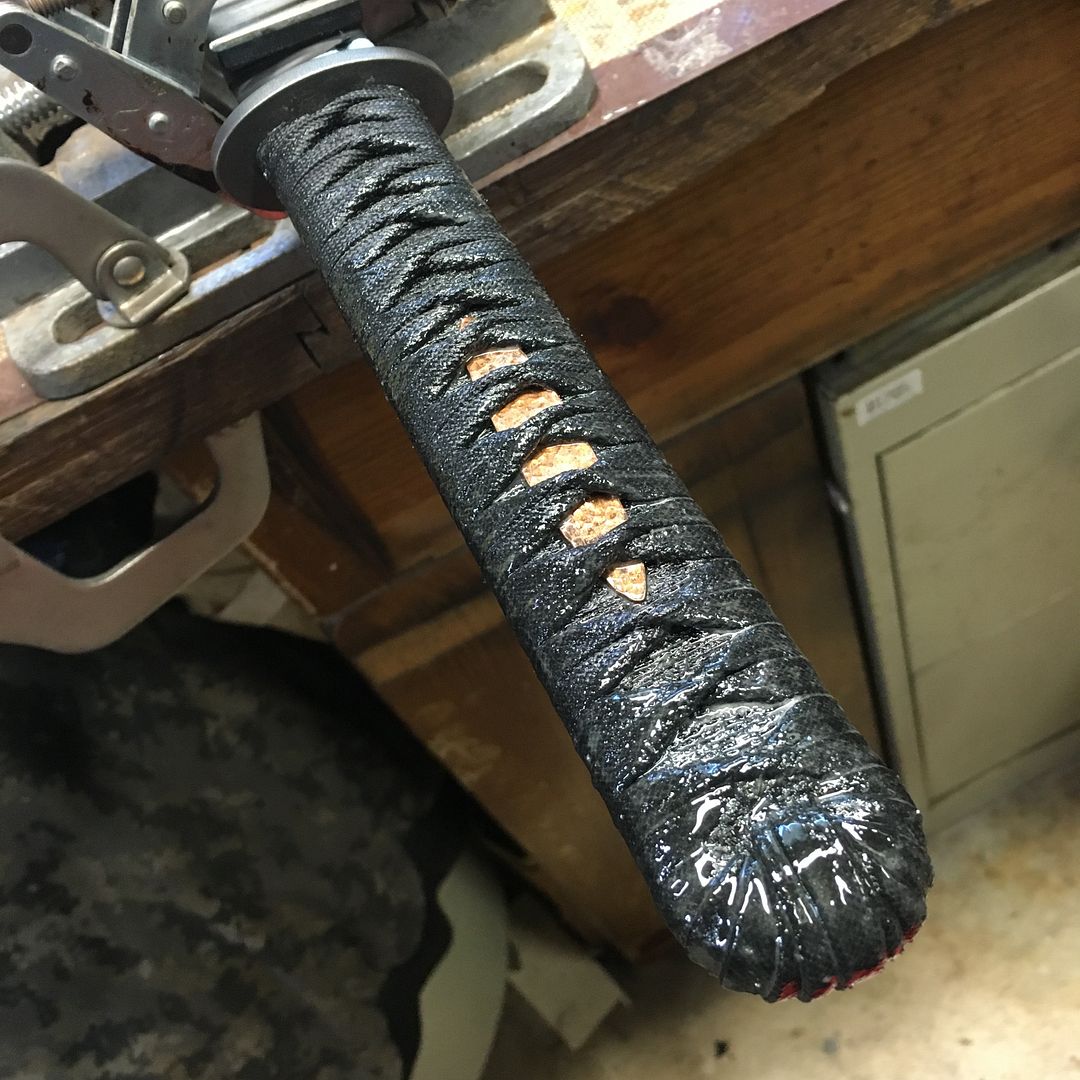

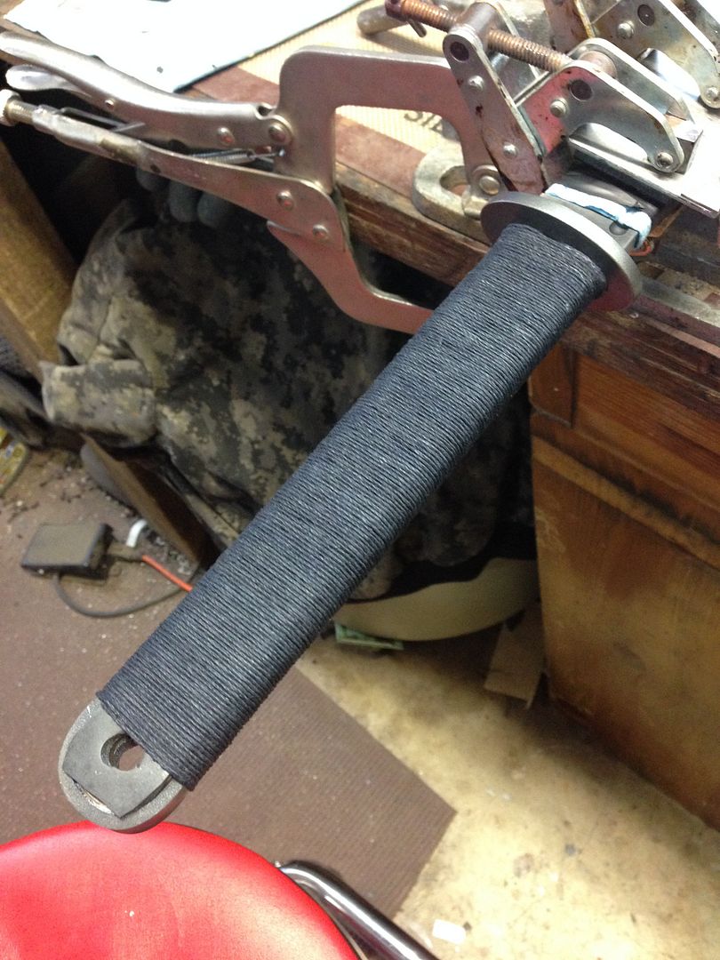

I use hard neoprene underneath the wraps on my Waki and tanto. It fills out the grip and adds nice shock (vibration) resistance when cutting. And unlike leather or wood it wont ever rot. : )
The finished hemp under wrap.

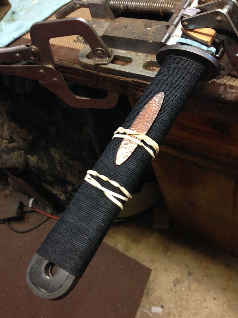

High tech menuki holding devices.

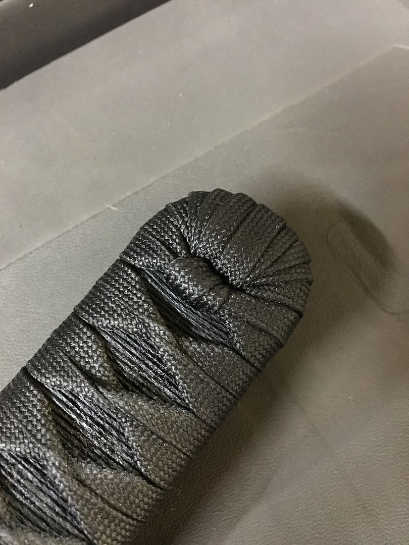

Since I only have two hands and no photographer, I don't have any middle of the wrap pics. But here I am tying the finishing knot. Bobbi pins are extremely useful here.
Here is the handle after the epoxy is applied. I use west systems G/flex for this. I brush it on pretty thick, it will soak in completely on the wrap and I will clean up the menuki and Tsuba.

Beautiful work Ben! Have or do you distal taper the longer blades for balancing? Ever tried tying a knot at the end of the handle wrap?

It actually has a knot, your just seeing the tag end of it. Here is the other side.
