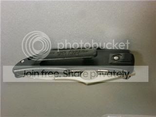

Hi, guys. I've got a Walker design folder with a pinned, molded handle which I carry almost every day. I made a mistake one day and wore it on a belt, which significantly loosened the clip. Now it sometimes falls out of my pocket, which is not cool in Japan where carrying a knife is frowned upon.
I talked to a Spyderco rep at the Seki knife festival who recommended the following fix. He said to put it in really hot water with the clip rubber banded tight for a while, then transfer it to cold water.
Any opinions on that?
The Walker is in the middle in this photo:
I'll try to get a pic of the clip up soon...
Thanks for your help in advance!
Kent

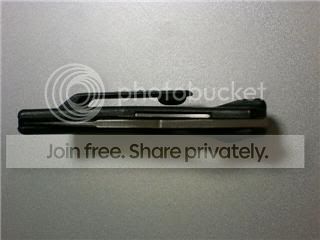

Okay, I tried it...
I put a plastic spoon handle in as a shim (thanks again, Mr. Deacon) and wrapped the end of the clip tightly with a couple of tough rubber bands. Using the spoon as a dipping/retrieving handle, I soaked the knife in boiling hot water for ten minutes. I then transferred it to ice water for several minutes (forgot to keep close track of the time in cold water).
The result was good, with a slightly tighter fit, but not back to "as new" condition. Of course, as far as I can tell, it had no detrimental effect on the knife or handle, so if I wanted to try again, I s'pose I could. The shim was relatively thin, just thick enough to create a very slight bend--perhaps if I were to use a thicker shim...?
Should I leave well enough alone?
Kent
